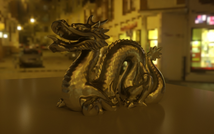

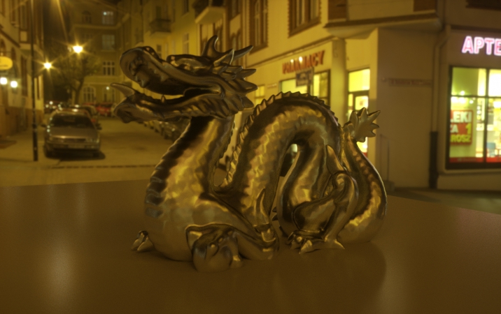

Hello,
just doing some tests with HDR light studio and found that
the hdri background appears in low definition when
using hdrls.
Don't know if it's an option i missed in the HDR light panel?
below the two renders (ipr and hdrls)
And by the way thanks Juan for the shaded view trick for the lightpaint problem,
i had the same issue and it works perfectly now
And thanks for all the work done on Octane, so glad to have such a wonderfull
renderer on lightwave!
Olivier
juanjgon
Posts: 8867
Location: Spain
The live image used for Light Paint in the IPR window is always a low resolution file to make all things run faster. Only when you render the final HDRI to file (or render to live) HDRLS saves a full resolution file.
