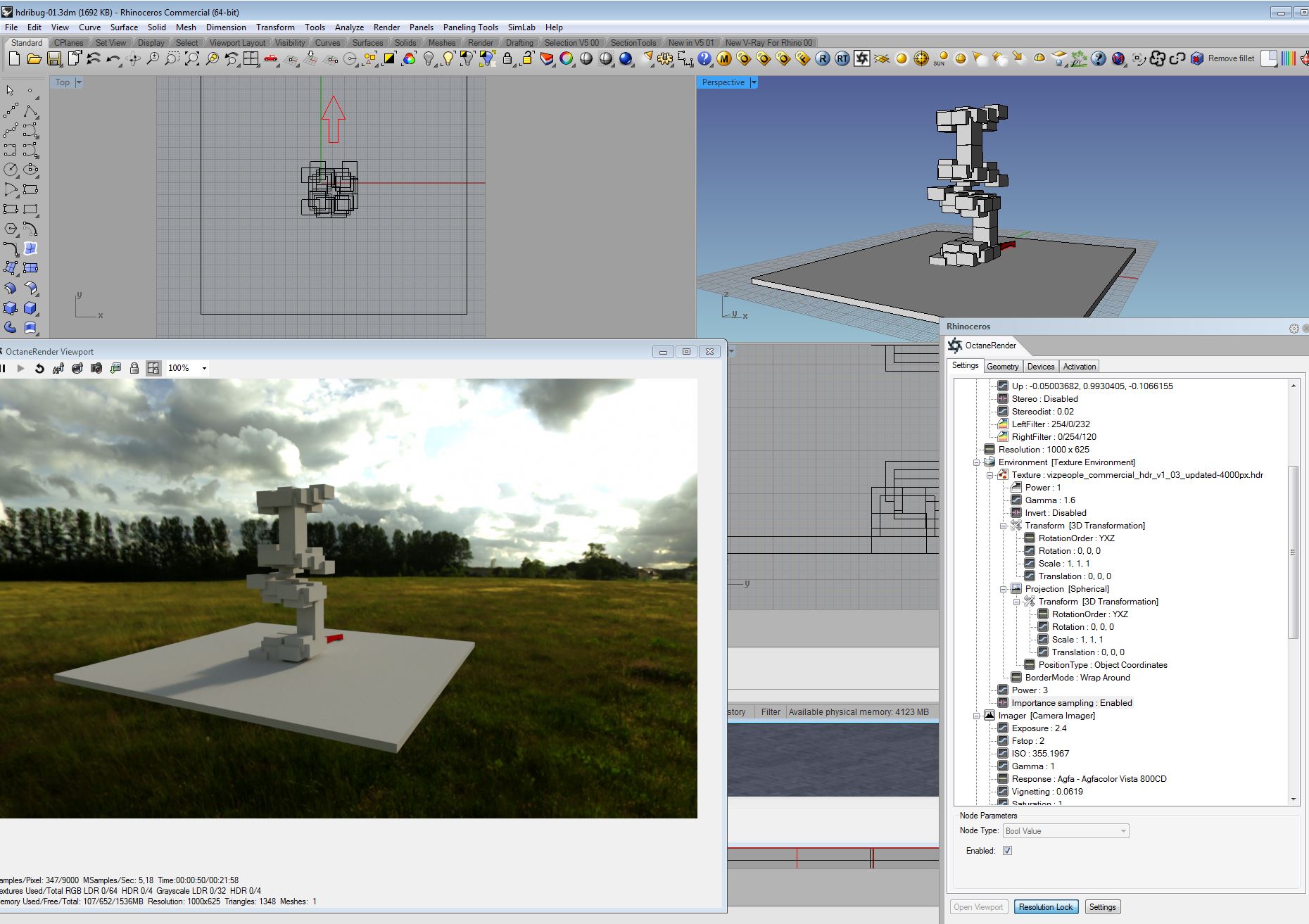

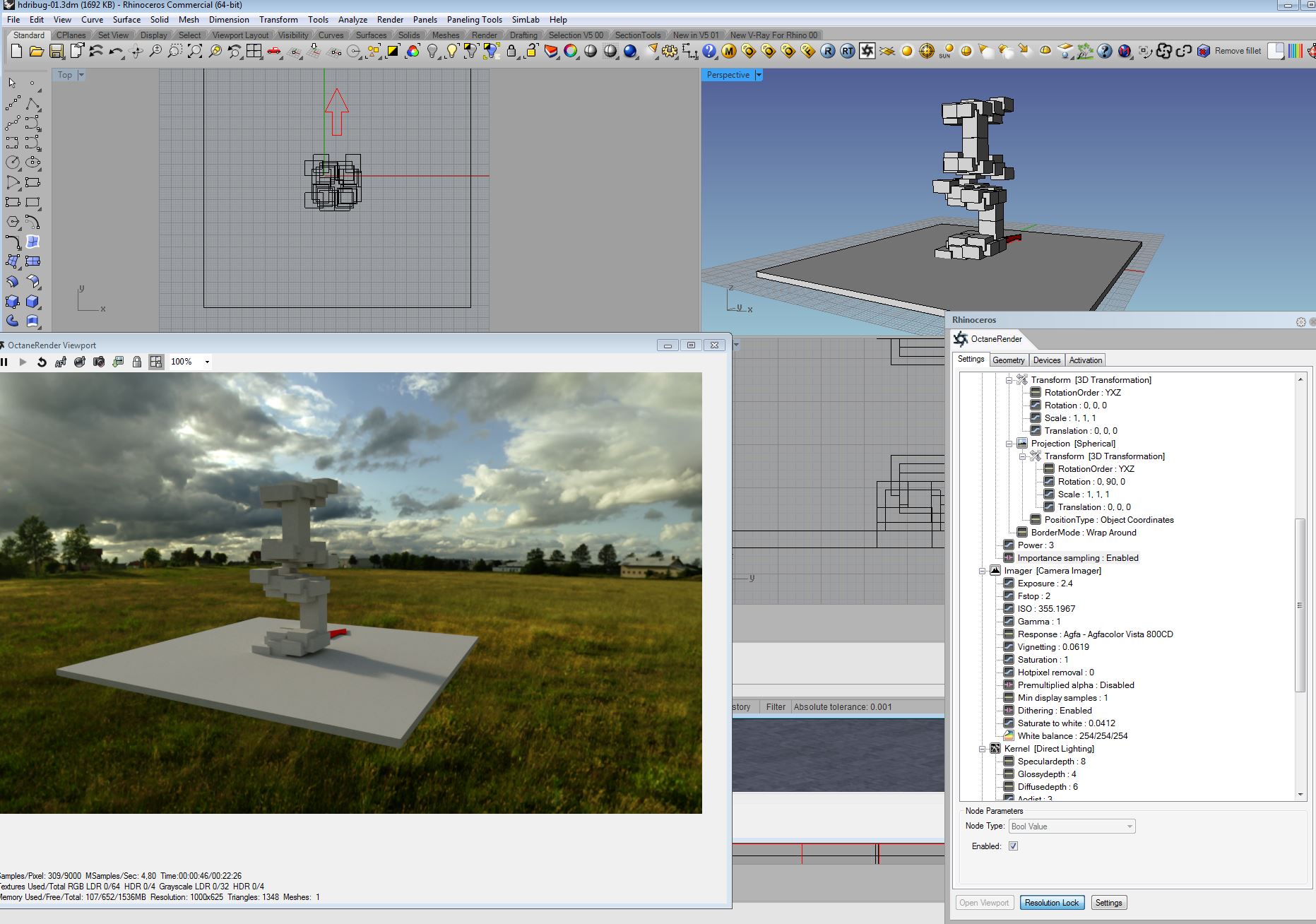

Hello Paul,
I revisited the HDRI map orientation issue...
Please take a look at the attached images, I think after rotating the image by 90 deg the importance sampling is somehow turned off (despite the fact that the button still shows "enabled")see pic2
after turning importance sampling off and then imediately on again, it seems to work as expected (see pict 3)...
initial Situation:
Hdri map turned 90 deg - Contrast is low...:
Same situation after briefly turning importance sampling of and the on again - contrast ratio is as expected:
can you confirm this?

Thanks Andreas
I will look into the duplicates when doing the 1.29 release, which will be soon. 1.29 also fixes some issues with LiveDb materials, and hopefully helps address the bluescreen crashes, and most probably fixes the HDRI rotation problem.
And yes - that is the same HDRI problem people have reported with other plugins on the 1.25 version of Octane - so it is a know issue, resolved with 1.29.
