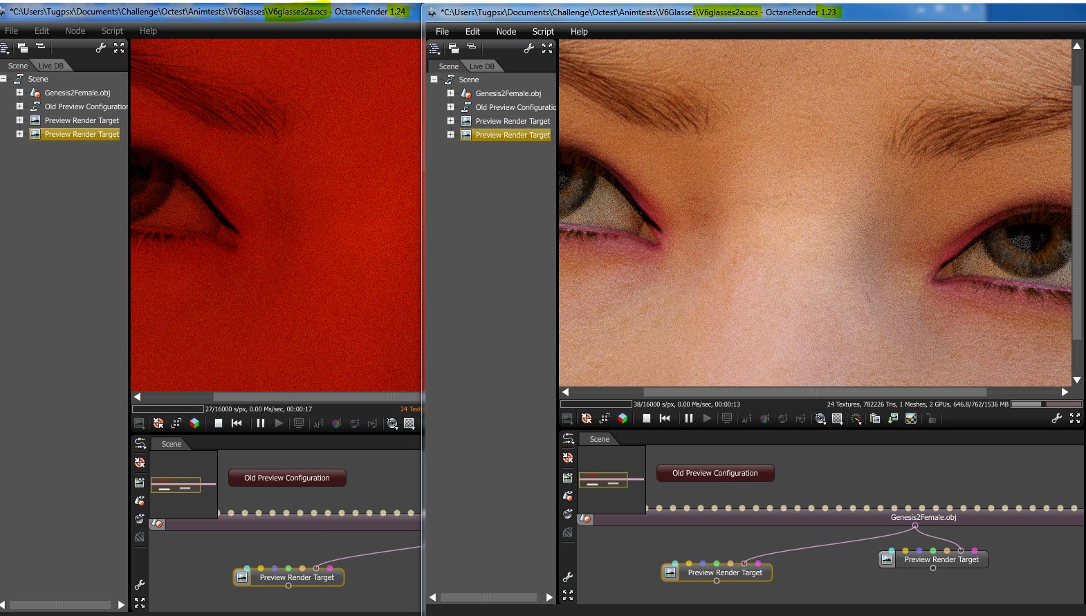

roeland wrote:
Tugpsx wrote:Thanks for new options, great to see you guys were putting in the extra effort during the Holidays. Much appreciated.
However, There is an issue with something here since these are the same scenes loaded raw in OC123 and OC124
The attachment OC123Capture.JPG is no longer available
The attachment OC124Capture.JPG is no longer available
Keep in mind that the subsurface scattering is dependent on the scale of the object. If the scale changes you need to change the medium scale setting accordingly.
Can you also verify with the infochannel/wireframe kernel if the normals aren't flipped?
Roeland
Nothing has changed here I loaded the 2 versions of octane with the same scene. interesting there are 2 render targets but only one has this problem.
Ocs 1.23 vs 1.24
Ocs 1.23 vs 1.24
roeland
Posts: 1826
Tugpsx wrote:Nothing has changed here I loaded the 2 versions of octane with the same scene. interesting there are 2 render targets but only one has this problem.
Someone else posted a similar problem, and it was due to the normals pointing inwards on the imported geometry. This happens if the geometry is exported with clockwise vertex order (Octane expects counter-clockwise order).
Otherwise, what are the material settings and the different render settings in the two render targets?
Roeland
Tugpsx
Posts: 1180
Location: Chicago, IL
Did a bit more experimenting and found that it is caused by the render target.
When this target is selected one of the GPU fails, yet if I select another render target it works fine.
The system has 2 graphics cards a GTX660 and GTX480, the GTX 660 is the card that fails when this target is loaded.
Badtarget.ocs
Bad render target
(24.73 KiB) Downloaded 222 times

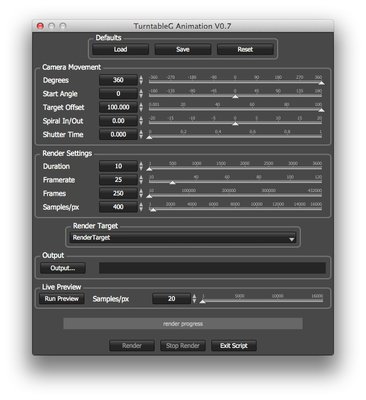

Posts: 10646
Rikk The Gaijin wrote:I see you point, but can't you just add a new window dedicated to animation, with all the needed buttons there? Something like Maya does for the different areas, modeling, animations, dynamics, etc, so the interface doesn't become too crowded, it just changes based on what you need. And possibly make the windows detachable, so we can move them to a second screen.
hi rikk,
trust me, lua script is a neat powerfull and flexible solution for expanding the octane functionality ;)
you don't need to dirt your hands with code if you don't want, you just need to create a directory for lua scripts and set it in the octane preferences.
octane team and other talented users are preparing very interesting and powerful scripts, you need only to save them in the lua directory and call them via script menu.
if necessary, the script could have an interface with extra window where you can easy setup the things ;)
we are in beta stage and the things must be refined, but for me is a very good way to go for the future ;)
edit:
just an example of what grimm is doing:
http://render.otoy.com/forum/viewtopic.php?f=73&t=37489
ciao beppe
