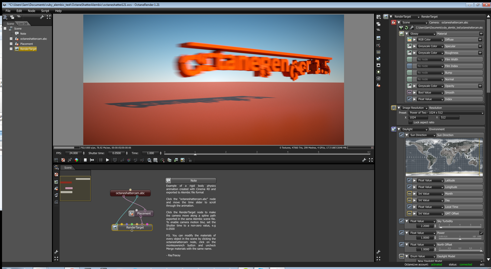

Hi all,
I've uploaded an Alembic rigid body physics animation with camera path to demonstrate how camera motion blur and rigid body animation works in Octane. Instructions are provided in the note.
OctaneShatterAlembic.zip
Example alembic animation
(3.32 MiB) Downloaded 330 times
Enjoy!
EDIT: to load the file in Octane 1.21, choose File -> Open and pick "octaneshatter121.ocs".
P.S. Alembic file import is still a work in progress and materials should be easier to modify in the next iteration.

RayTracey wrote:Hi all,
I've uploaded an Alembic igid body physics animation with camera path to demonstrate how camera motion blur and rigid body animation works in Octane. Instructions are provided in the note.
Enjoy!
does not operate, requires OBJ
