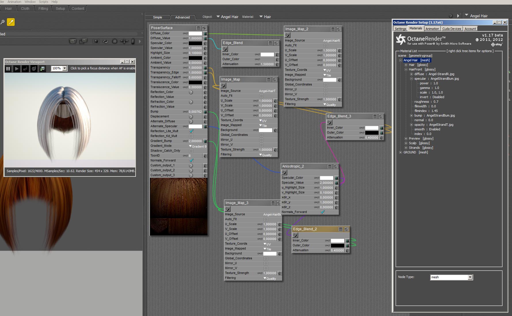

I don't know what is wrong with the hair. Everything is UV'd. There was some texture maps a bit outside of the UV map, but I have seen that before and shouldn't be a problem.
But I loaded the OBJ from the geometries folder into Modo and just saved it again. That fixed the problem

I didn't fix anything. The OBJ was fully UV'ed. I just opened the OBJ and saved it as OBJ. Done. It still has out of range UV coordinate data as the original OBJ had. But Modo most have changed something that's for sure.

Yes, Modo did a cleanup when you imported it and assigned all the IV's, so when you exported there was a UV coordinate for each vertex.
For skin or non-skin materials?How do I force the scene to use glossy specular 0.05 ? It seems every time an image is connected to the specular pin it's set at 1.0.
Is it possible there is a specular map attached i the Poser material?
Paul
For non-skin materials. I was trying out different hair on a figure, but about 80% had a specular map attached and octane set it to 1.0. Was messing around in the config file but that didn't help me as it use to do.
Win 11 Pro | i5 12600K | 32GB ram | 2x GTX 1080Ti + 3080Ti - studio driver 560.94| Modo/Blender/ZBrush/Daz/Poser
If there is a specular map attached in the Poser material, then that material will convert to an Octane glossy, with that specular map attached to the "specular" pin.For non-skin materials. I was trying out different hair on a figure, but about 80% had a specular map attached and octane set it to 1.0. Was messing around in the config file but that didn't help me as it use to do.
If I load the default Andy scene into the plugin, the ground is glossy, with specular at 0.05. Which is the behavior you are looking for. Perhaps if you post a screenshot of the Poser material and the Octane material that it is converting to I can reproduce the issue and investigate further.
