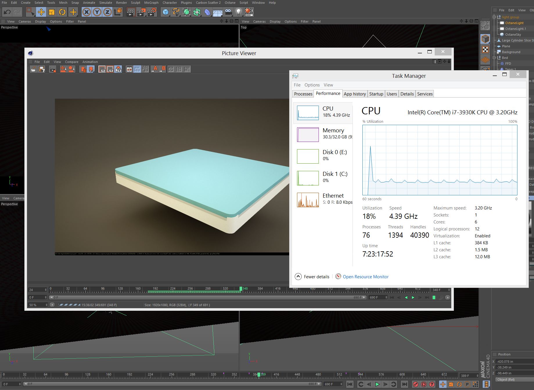

I've run into a big issue. There seems to be a HUGE memory leak in this version (.5.7). Attached is a screen shot of the issue. As you can see, this animation ran for a little while and then stalled on a frame and continued to "render" that frame for 15 hours. Now look at the memory usage. Over 30 gigs! It flat out ran out of memory. This is a very simple scene too. 18K polygons.
This is a classic memory leak that needs fixing quick. I had two machines rendering this and both froze.
I think it was Immortalarts that was posting similar issues with his scene. This is a deal breaker here.
Can you check this out?
Alec

yes, if you attach file will be helpASyme1 wrote:Hi Aoktar-
