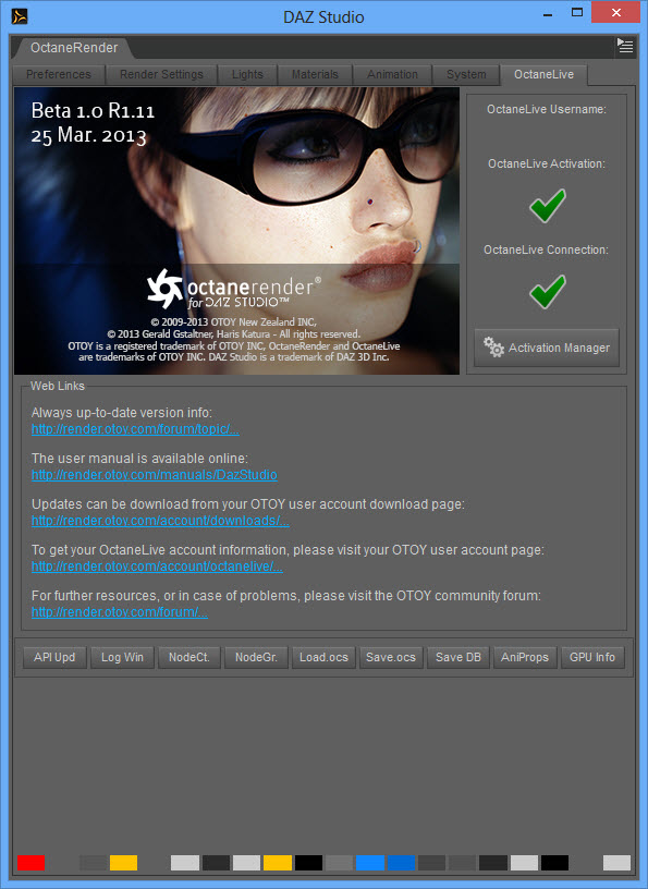

I tried to update from an earlier version and it still showing the old version though some buttons have changed... Im not sure if i updated incorrectly.... Anyone have any input?

wlebrun wrote:I tried to update from an earlier version and it still showing the old version though some buttons have changed... Im not sure if i updated incorrectly.... Anyone have any input?
currently only the build numbers and octane versions were updated (history and explanation here: http://render.otoy.com/forum/viewtopic.php?f=44&t=30137) - you will find the exact version number in the system tab above the message box...

thank you I am on track again.
