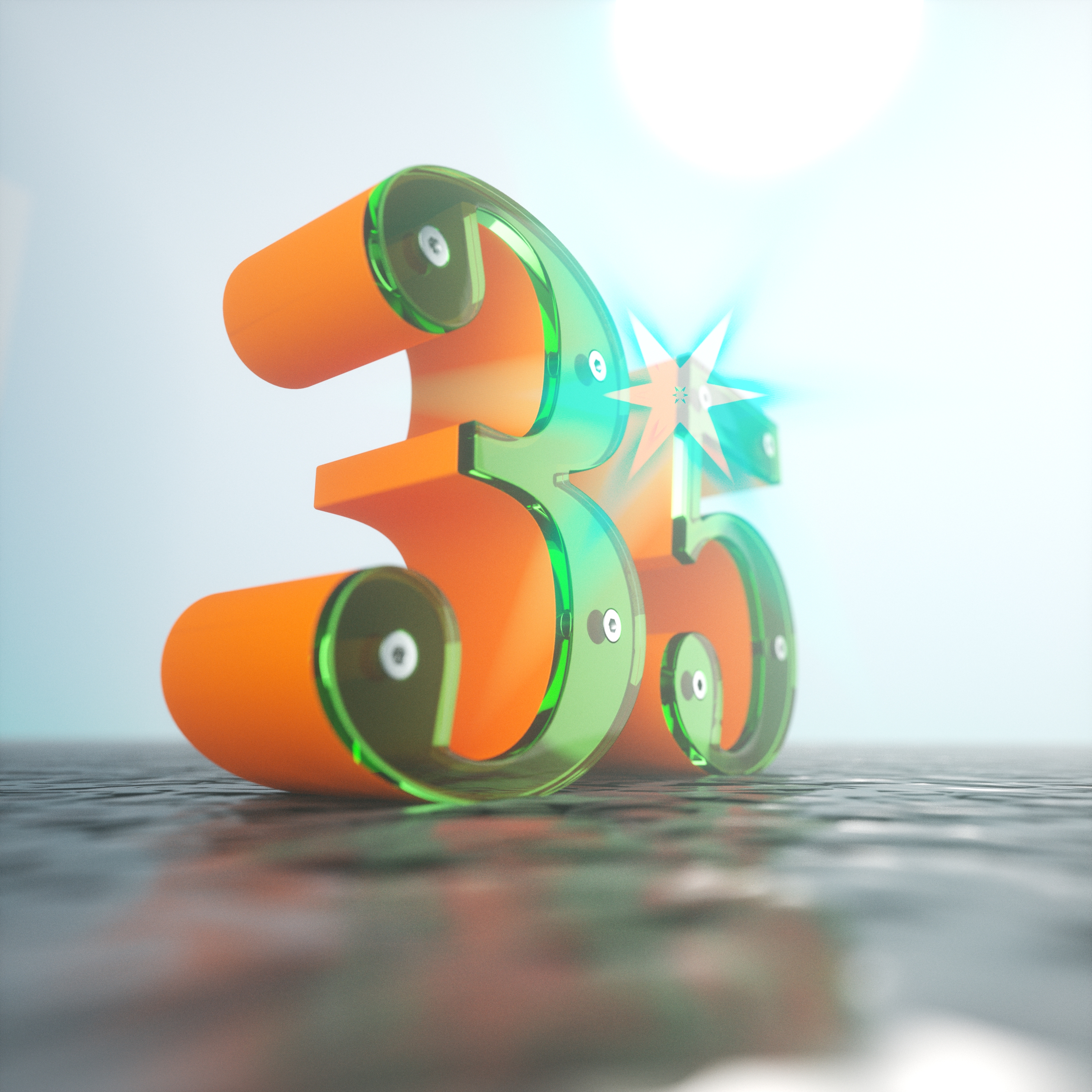

Strange star in post processing after 2000 - 3000 samples

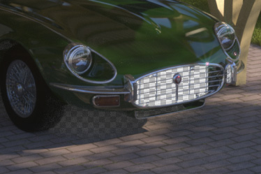

Shouldn't the transparent glossy stuff not fixed??
Just rendered an image and got this:

mbetke wrote:Shouldn't the transparent glossy stuff not fixed??
We will have look on it. What kernel do you use?
I used Pathtracing.
