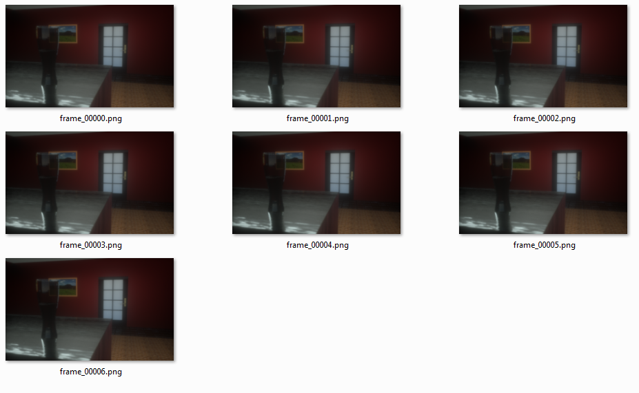

OK, heres a quick update on how things stand right now..
If I create a new project and load in all my `set` OBJs and render just that (with blackbody emissions, which i can edit!) then all renders fine as a PNG sequence with out the alternating film grain `effect`..
BUT, Saving the scene after adding the blackbody emission is not perminant! After saving & exiting DS and reloading the project I click on the light bulb OBJ and then on nodegraph editor and (suprisingly it does not crash at this point but) the blackbody emission has been removed from the chain!

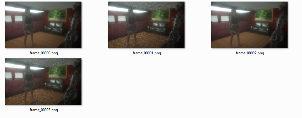

Also,
As soon as I load in my characters (M4_Cyborg & a Genesis character), then things start to go wrong!
Sometimes I get a crash when hitting the render animation button, but when this crash does not happen then the alternating film grain `effect` comes back!
As soon as the alternating frame begins to render it is saved with low samples and not updated at all, either during the render OR after the frame has rendered completely in your plugin...<br /><br />Like you said, its a timing thing!
