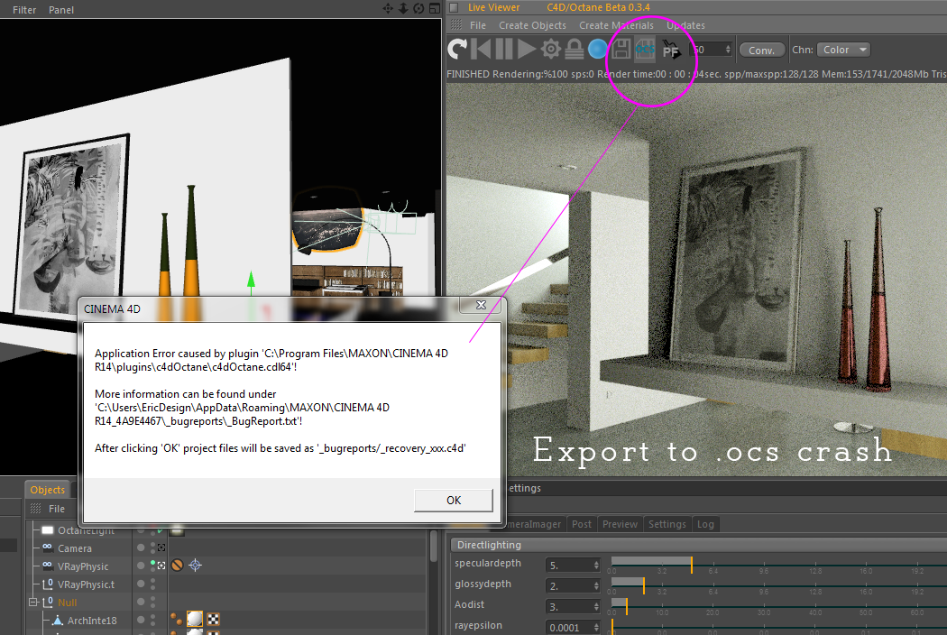

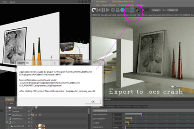

I find new bug if i export the files .ocs C4D crash every time. thx
EricDesign: we use 1.11 sdk, OCS export is broken in this version. I'll fix asap.
