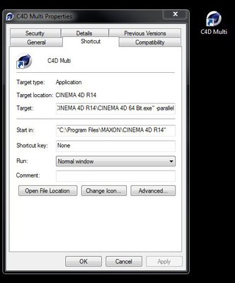

mauricesteenbergen
Posts: 31
Joined: Tue Dec 04, 2012 9:37 am
aoktar wrote:"c:\Programme\MAXON\CINEMA 4D\CINEMA 4D.exe" -parallel
from windows menu
I just created a new desktop shortcut with the -parallel added, and named it C4D Multi
So now you can choose if you start a single instance or multiple. (in case you click too many times).
