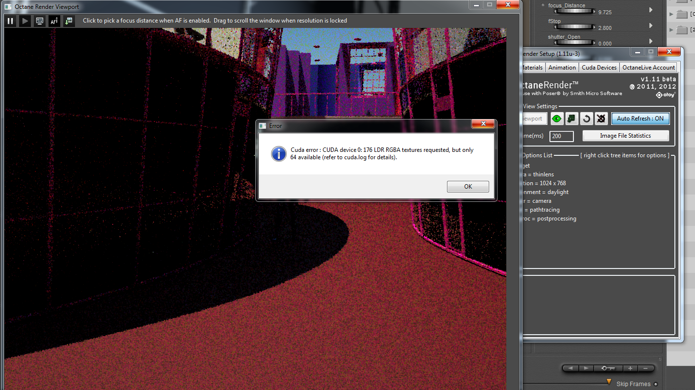

The viewport output goes purple or the plugin crashes with various error messages.
Can you provide more details on the error pls? When it happens, send me the cuda.log file (from the Poser temp folder). One thing I've found is that sometimes a card is faulty (happened to me) - and it's only when rendering via Octane that the fault becomes apparent - so that could be the issue. In general, if you are getting a cuda error other "out of memory", its a card fault. What is the compute level on the card (displayed int he plugin in the Cuda Devices tab). Something else to try.......install Octane standalone on the laptop, add a diffuse material, click the diffuse material, pause the render. Now run Poser and the plugin. What that does is keep the card "active", so voltages, clocks etc are at full operating levels even whilst the Poser plugin is not rendering.
Compute level 1.2 on my laptop and 2.1 on my desktop.

Please see attached image regarding viewport being purple/pink..
Cuda.log only has two entrys:
Opening OctaneRender for Poser Setup Dialog
Closing OctaneRender for Poser Setup Dialog
I have attached octaneplugin.log for you also.
Ah ok - that one is easy - you have too many texturemaps in the scene. Way too many! There are 176 color texturemaps in the scene (Stonemason's I'm guessing) and your card has capacity for 64. 600 series cards will do 144. Use the Scene Texture Counter script (see the plugin manual) to get an analysis of where they are being used. Make part of the scene that outside camera view invisible to use less maps. But getting a full stonemason scene into a pre 600 series card will be a lot of work - simply because there is so much scene.
This is relating to my Laptops graphics card: Geforce GT 330m, your totally right there... the scene renders fine on my desktop with the NVIDIA GeForce GTX 460 but I get what you mean and plan to upgrade the desktops card ;)
I am not absolutely certain about this, but I think the desktop is actually not rendering the scene fine (it will be running out of texturemaps too), but due to a different compute model on the card, or different Cuda drivers, I suspect the desktop is not reporting the cuda error whereas the laptop is.
