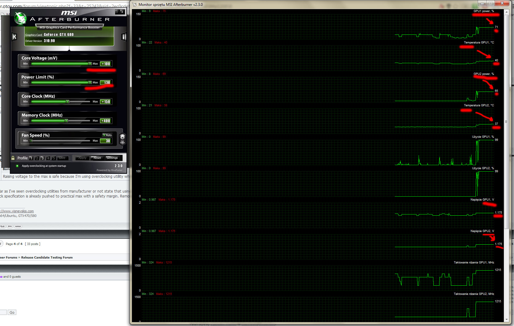

My GPU voltage is set to max and I also force its constant voltage (no failures, better stability). GPU Power is also set to max but Octane uses only about 70% of GPU max power. Both GPUs are watercooled so temps are low, about 40C.

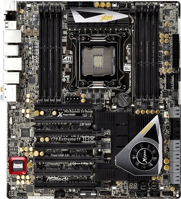

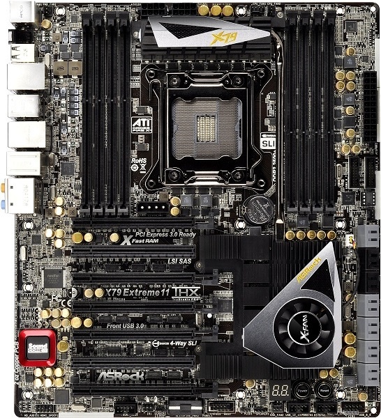

not so long ago I've tried to look for a possability to house more than four GTX cards in a rig that would have only one CPU. after some time spent online searching for info I've found a mobo that has:
x79 based board for LGA2011 with..
two PLX PLEX 8747 (that effectivelly gives 72 PCIe lanes - & that's enough to run 7cards!)
the biggest problem or let's call it the obsticle is that You actually have is one slot spacing if You want to populate it full.
You can always use risers, but for that means custom case for the rig too..
and for some it's a bit of a problem & is not an option =)..

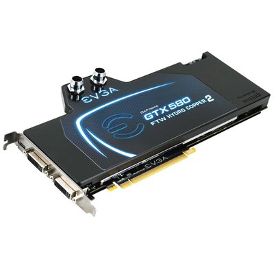

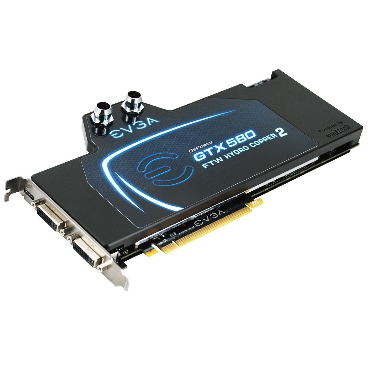

so is there any solution? well..there has bean a card from EVGA..
watercooled single slot design option of GTX580 (HydroCoper).
these are pricy products..for sure, but considering what You get.. - reasonable priced overall.

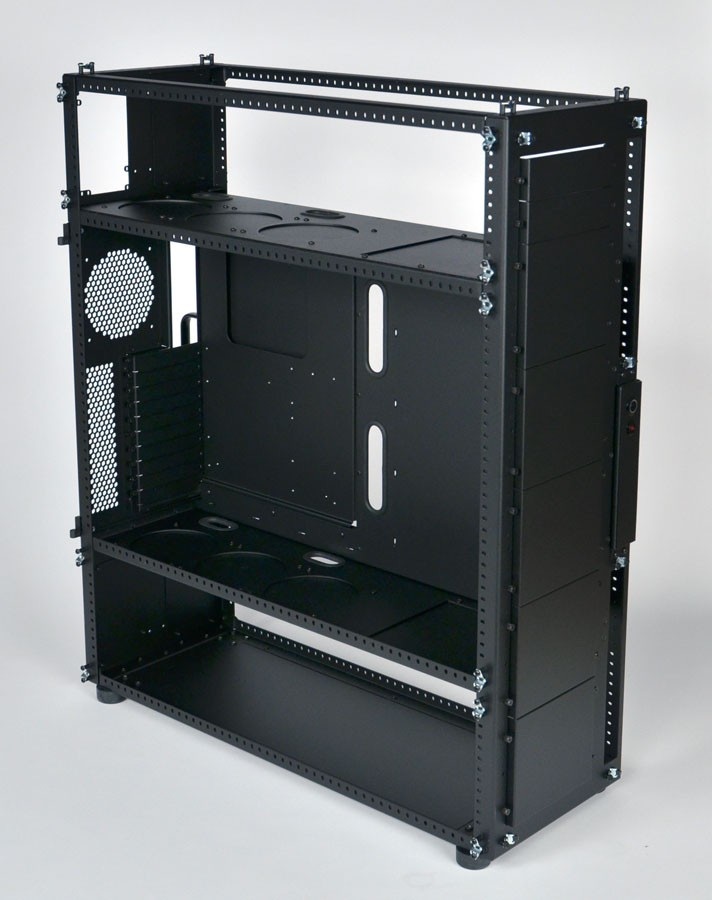

&..with modular case, something like CaseLabs STH10 You can get enough space, not only for all this, but for big rads, multi GPU, pumps, multiloop.,etc. - everything out of the shelf, without any need for modding.

http://www.asrock.com/mb/Intel/X79%20Extreme11/
