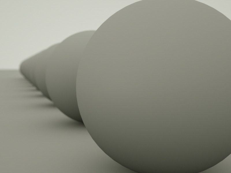

Psimoh wrote:
mikinik wrote:bicket, to disable DOF set aperture 0.01
..which you can do with a single right-click on the spinner. So it's a one-click fix!
I don't think so.
Here is an example : sphere diameter = 1 cm / aperture = 0.01 => you could clearly see that DOF effect is active.
I have to render gold rings (#1cm diameter).
In order to avoid DOF, the ring have to be 1 meter diameter :?

bicket wrote:
I don't think so.
Yep, I see your point. I re-created it and got exactly the same.
A cludged solution would be to use the "Rescale World Units" utility and up-scale the whole scene by a factor of at least 10. Animations may suffer from the re-calibration of the numbers, but static objects should be fine.

I can reproduce the problem. Will fix it.
Karba
Posts: 2300
bicket wrote:
I don't think so.
I will fix it.
