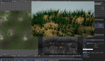

I've uploaded the grass example scene by Roubal, exported with the 0.1.5 update (that corrects particle size). See first post.
As you can see on the screenshot, the grass is varied enough (rotation and declination around emitter normal, size varies) and the render in Octane corresponds exactly as the viewport in Blender (as long as you don't mess with forbidden parameters :) - read first post for guidelines). Also note the rotation of the dupli object in the wireframe view.
Render speed in Octane is damn slow though (only 1megasample wit DL & 500 instances on my GTX 460)... I hope this will improve.
