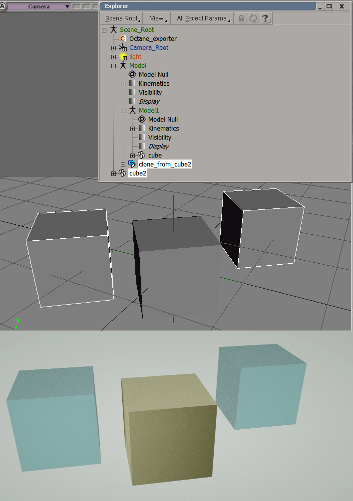

Problem with the models solved...
cube2 in root, clone_frome_cube2 in model and cube in model1 under model.
cube2 and the clone share there material, image below.
