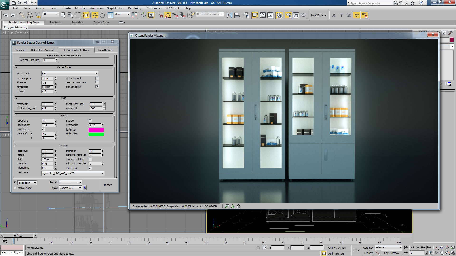

Posts: 2300
MaxPower wrote:I am using your latest Max plugin and I have a lot of noise in every rendering that is not in a daylight bright scene. The Noise is Killing me! This is a simple medicine cabinet from Evermotion. To provide light inside the cabinet I added 4 blackbody emmission tube lights to the corners of the inside. I have tried every setting for Direct, Path and PMC. I have changed materials from diffuse to glossy etc....but have had no success getting rid of the noise. I have also read the posts and changed to millimeters...No Help. What"s next?
Dual Quad core 5540s, 12 gigs ram, 2x580 GTX 3 gigs
I have set you an email with corrected scene.
You have to make light source geometry as simple as possible.
Now it looks like this
MaxPower
Posts: 7
Joined: Thu Dec 01, 2011 4:43 pm
Karba,
You ROCK! Thank you so much. Octane Render is clearly the best....I am very happy with the direction this is going.
MaxPower
Posts: 7
MaTtY631990,
My problem was that my Blackbody emission lights were not simple. I used a many faced cylinder has like a Fluorescence light instead of a flat simple plane. My problems are solved. :)
