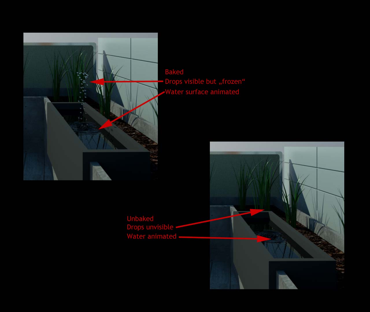

Hi all,
usually I have Rhino for modeling and octane for rendering. Since Rhino can´t do animations I "abuse" Blender for this. Plus the exporter for Blender is real pleasure to work with! Thank you so much yoyoz!
Now there is one problem I have. I tried to make an animation with a little fountain in a small basin. I used particles to animate the water"drops" and used the new Dynamic Paint in Blender 2.61 to have the drops react with the water surface (creating waves etc.).
While playing the animation in Blender everything works just fine, the drops rise and fall and create nice little waves when touching the water surface.
Now something strange happens when I export the scene to octane. When I bake all physics, the drops will be visible in octane but they don´t move, whereas the water surface is still animated. When I don´t bake the drops disappear but the water surface is fine.
Somebody have an idea?
Thanks in advance
stiwi

Vipvip, isn't this topic helpful?
Concerning the DOF and camera animation via command line you should refer to Octane user's manual for command line camera parameters.
Stiwi, if your drops are made with particles, you should see this post first — maybe you'll find your answers there.

Hi, I still can´t get my fountain to work properly. I tried aLexxtoR´s hint but maybe I did something wrong. I reduced my project to surface, fountain and camera and attached it. Maybe someone can find out.
stiwi
