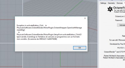

Posts: 13
Joined: Sat Apr 05, 2014 12:12 am
Hi guys ,
I have this problem :
could you help me?
face_off
Posts: 15728
Location: Adelaide, Australia
Hi - can you please post the info requested in the first post of this thread?
Paul
