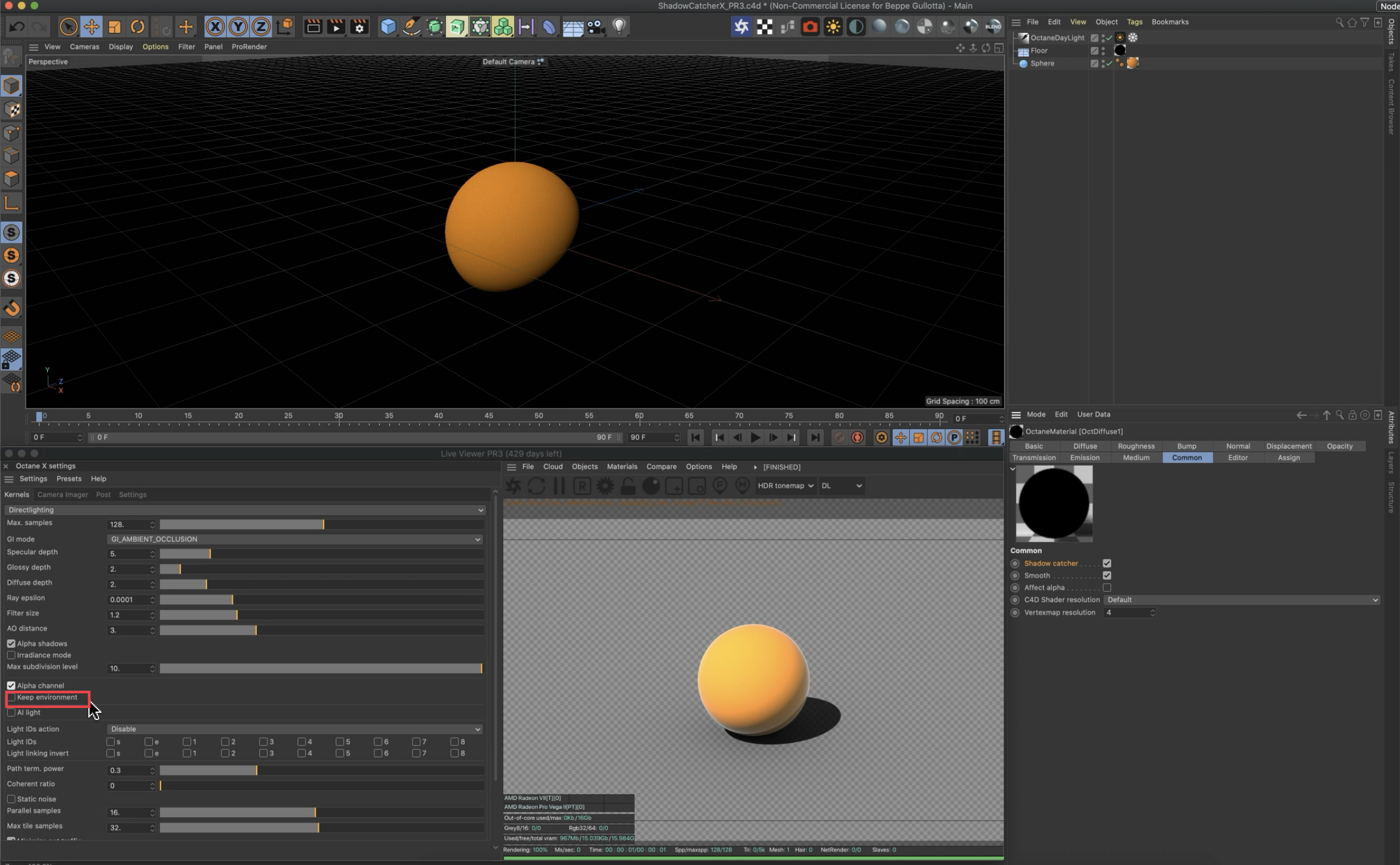

Anyone was able to successfully use the shadow catcher in PR3 ?
I still have the same issue: the shadow is brighter instead of darker. Or the shadow is invisible but the geometry plane that was supposed to catch the shadow is visible.
This is depending on what tutorial I am following. I was never able to have a result that would be a useful shadow catcher.

@pjano: about Shadow Catcher, please try with the following scene:
ShadowCatcherX_PR3.c4d.zip
(48.17 KiB) Downloaded 567 times
what is important to check is that the Keep Environment option is disabled, and Alpha Channel enabled, in the Kernel settings:
