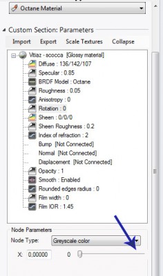

I tried to install the last version of octane for rhino 6. I have some trouble with slider and values of material node. Is it an octane problem or rhino 6 problem?
Fabrizio, I have some more info on this. I think this issue is due to your Windows->Settings->System->Display->Advanced Scale Settings->Custom Scaling is not set to 100%. This issue is resolved in the next release of the Rhino6 plugin, but in the meantime, changing this scaling back to 100% should get you operational.
Paul

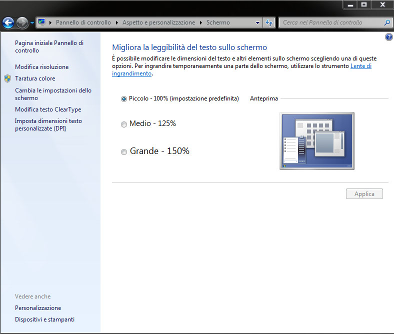

Hi Paul,
I'm looking for this path file but I'm not able to find it. Maybe is a path of win 10.
I have win 7 and in this os I have found this window. As you can see font scale is already at 100%.
bye
fabrizio

Sorry Fabrizio, I don't have a Windows 7 PC, so I think you'll need to wait for the next release of the plugin. It is fixed in the current commercial TEST version, but not yet in the Subscription version.
Paul

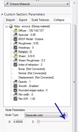

Hi Paul and thanks for the subscription version. So far it seems working well except for the maximum level of values. I tried to enlarge the window but without result. See the images below.
My monitor is 1920x1080 px, Win 7, gtx 1080 ti
bye
fabrizio

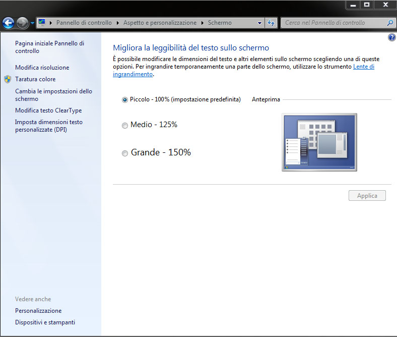

Can you pls show me your Windows Font Scaling setting? Is it the maximum level of float numbers, int numbers or both?

bye
