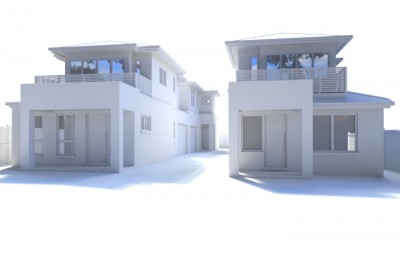

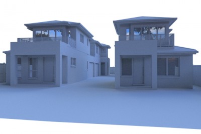

Hi Paul, getting some strange results with the nodal environment (Use RGB Color)
Here's the basic node tree:
Which looks as it should:
Then I add an Octane Color Correction node:
And it messes with the gamma or something:
I'm sure I saw a video you made showing this setup for colour correcting environments, I'm sure I tested it at the time and it did work on an earlier build.

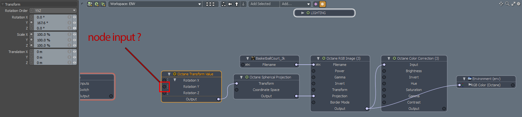

How do I gain nodal control over this input? As opposed to inputting the number manually, I'd like to connect a node to control this value.
Cheers,
Dino.
