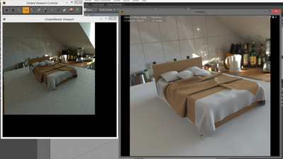

I´ve found some mismatch between octane and modo camera representation. Is this in the to-be-fixed list, or am I doing somethingo wrong?
AMD FX8350 8 cores. 16GBs RAM
GTX690
Win8 64.
face_off
Posts: 15812
Location: Adelaide, Australia
See point 2 at http://render.otoy.com/manuals/Modo/?page_id=185. This is something on the TODO list (to support the other scan modes).
Paul
