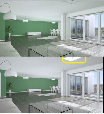

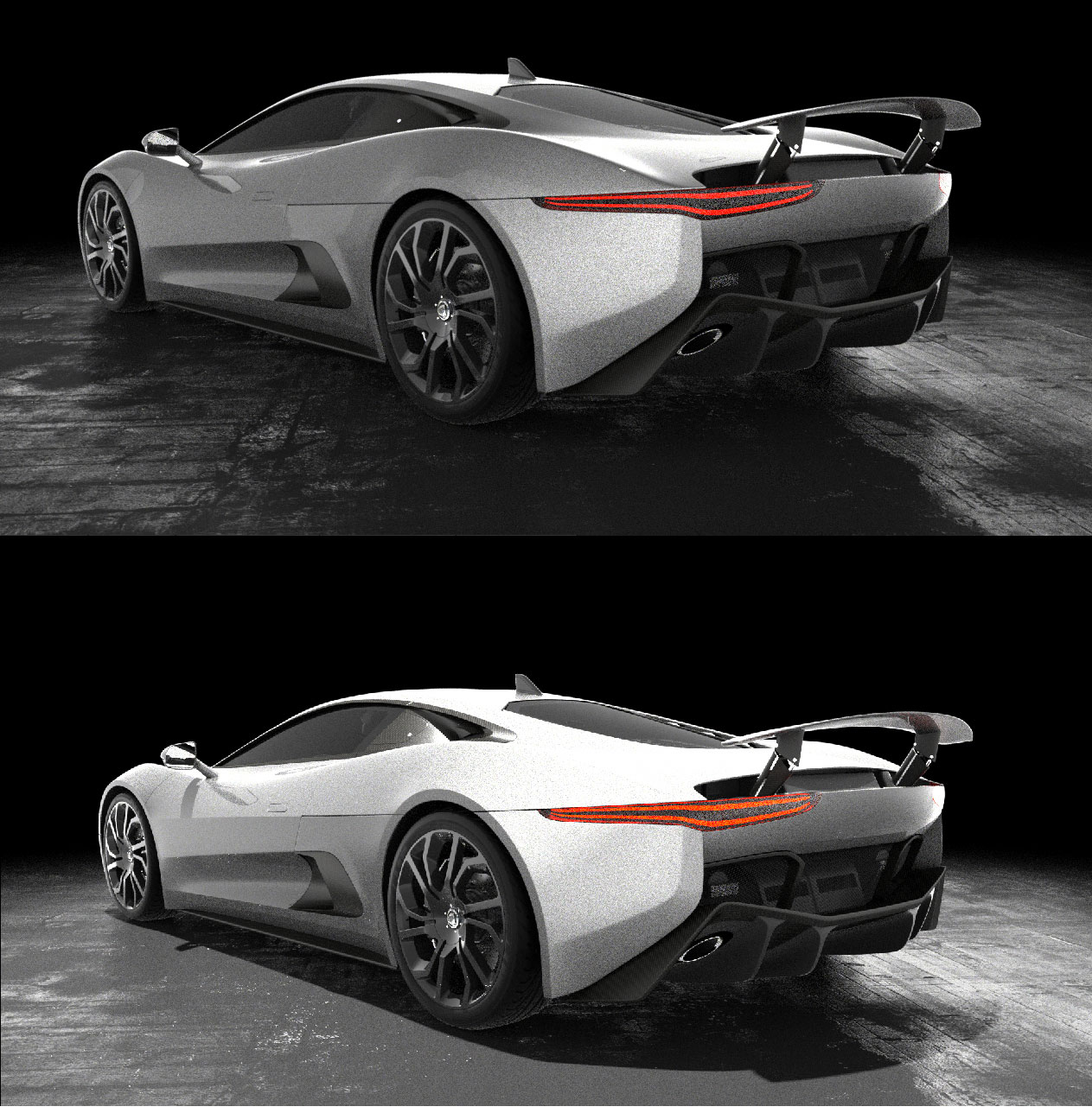

Hello aoktar,
1. i have some problems with the liveviewer output and the rendered output. It looks different and wont render what it shows on the LV.
I attached 2 images that show what i mean. The upper image shows the LV output and the lower shows the rendered output.
Once it does not shows emission objects (Interiour Image - the lamp and the green (fake)colorbleedemission object from the wall) and it seems to have problems with using a sunlight and a sphere with hdr for reflections (car image)?!
The settings from liveviewer are copied to post. I used the newest build on R13/ Win7. I just switched from c4d 1,13 to the newest one, but the problem appeared on older versions also.

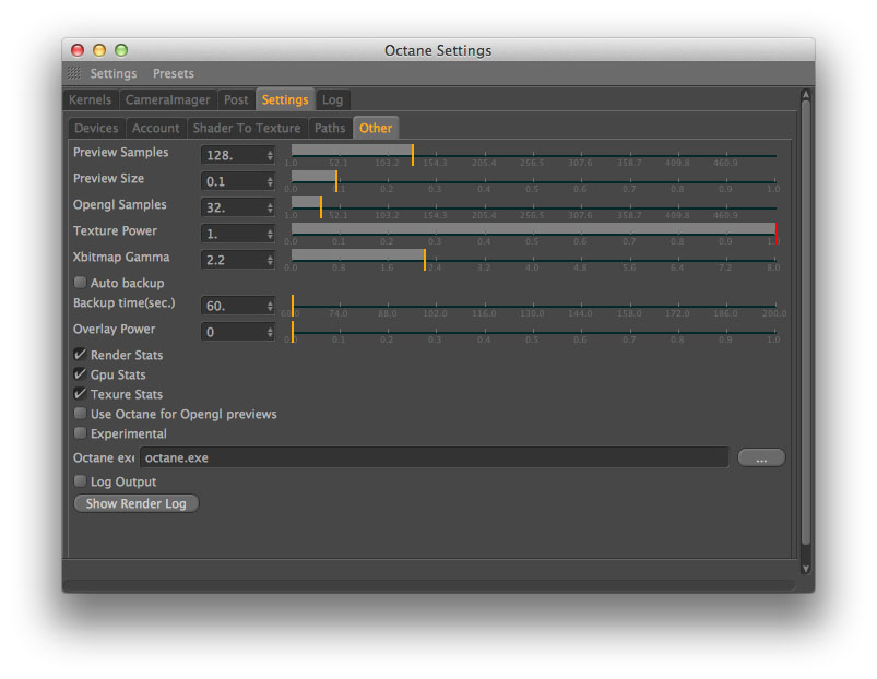

Hi Aoktar,
the preview for animation is gone.
What is the «Experimantal»-button for?
ciao, David
