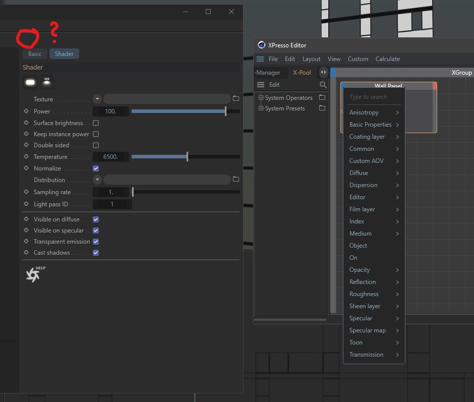

I don't know from which version but there is no way to drag Octane nodes to xpresso window because they stopped to show in C4D attribute window and they visible only in Octane node editor. But unfortunately there is no "window caption" to drag it to xpresso window.
I can drag only whole Octane material but not individual nodes

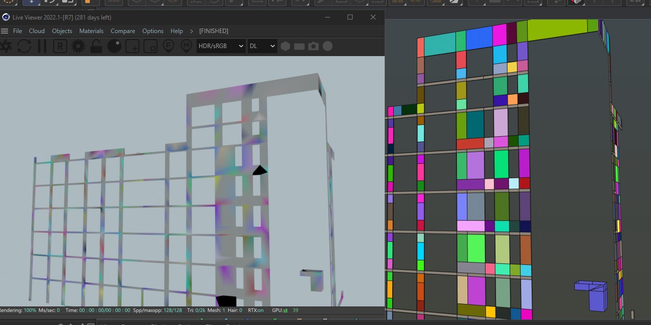

There is issue with vertex map when it is created while polygons are disconnected. After connecting polygons again it shows totally different than in C4D :
Scene included.
It is caused because Octane doesn't support vertex map Polygon Points mode - only point mode.

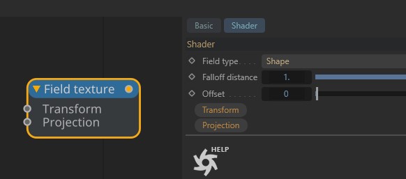

There is no Vectron, SDF input for Field Shape :

jayroth2020
Posts: 495
Joined: Mon May 04, 2020 7:30 pm
@SSmolak, right-click the attribute you wish to drive with Xpresso and choose "Set Driver" from the menu. This will create an Xpresso tag with the relevant information, which you can then copy/paste anywhere you need. It's described in the manual here: https://docs.otoy.com/cinema4d/UsingSet ... resso.html

jayroth2020 wrote:@SSmolak, right-click the attribute you wish to drive with Xpresso and choose "Set Driver" from the menu.
Yes, I know that but old way by dragging node doesn't work. At the moment we must use workaround by creating new xpresso and copy-paste method.

SSmolak wrote:I don't know from which version but there is no way to drag Octane nodes to xpresso window because they stopped to show in C4D attribute window and they visible only in Octane node editor. But unfortunately there is no "window caption" to drag it to xpresso window.
you can drag from material manager

SSmolak wrote:There is issue with vertex map when it is created while polygons are disconnected. After connecting polygons again it shows totally different than in C4D :
Scene included.
Please stick to feature what we are supporting
