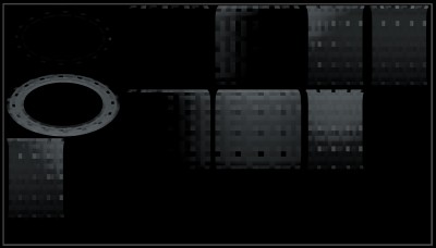

Hey everyone what am I doing wrong? Used this tutorial https://www.youtube.com/watch?v=7tTLH8wqMYQ
When ever I subdivide object it gets artifacts, no matter C4D native or inside Octane.

Hi kinedix,
are you using c4d shaders in your Octane materials?
If yes, you need to increase the baking resolution in c4doctane/SettingsC4D Shaders panel.
ciao Beppe

kinedix
Posts: 9
Joined: Wed Jun 10, 2015 9:34 pm
Just double checked, that test was with standard material, and I replaced with Octane diffuse material, and exact the same result unfortunately, but thank you for suggestion.

@kinedix: please use Octane materials with Octane node only inside, when working with Baking Camera.
