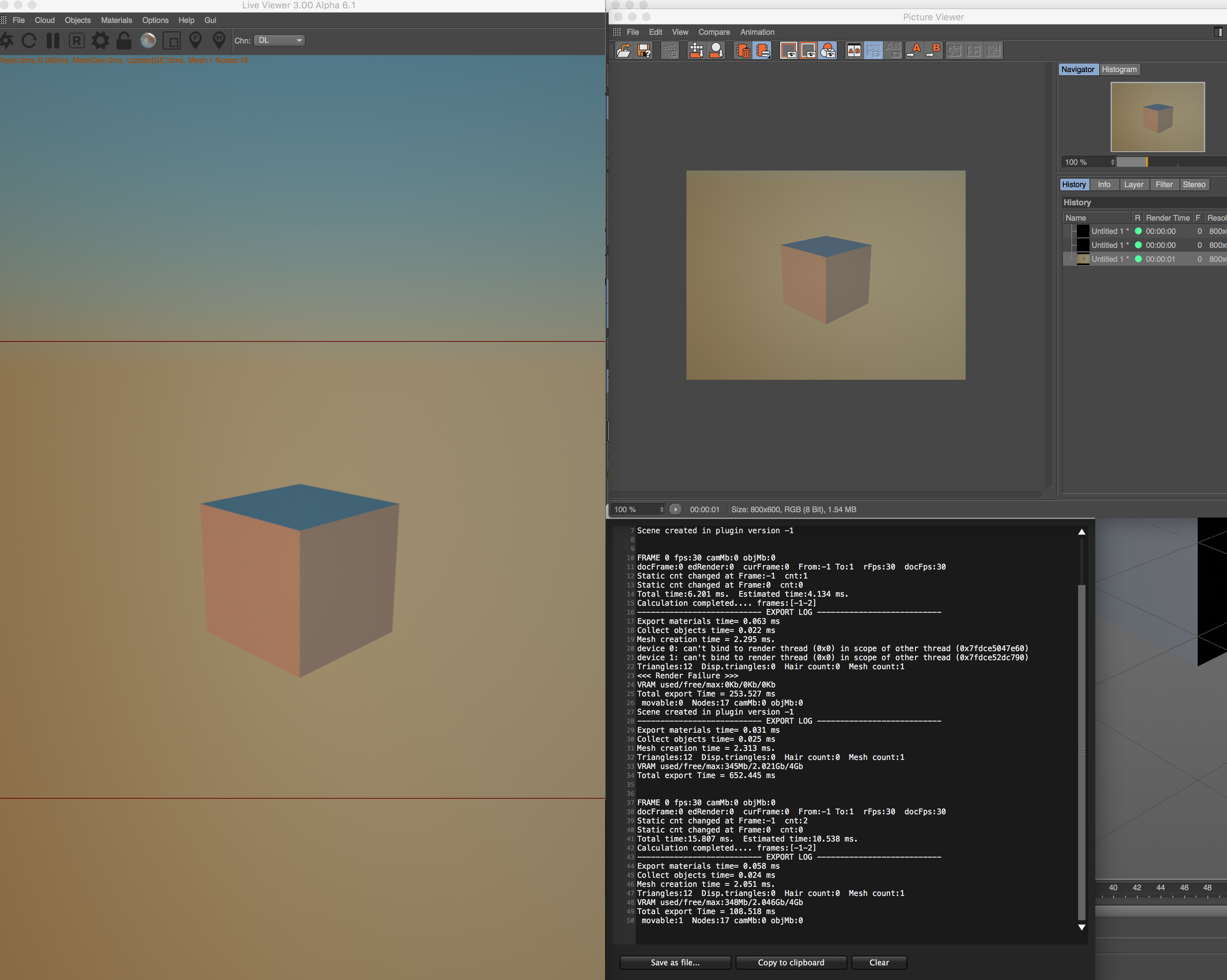

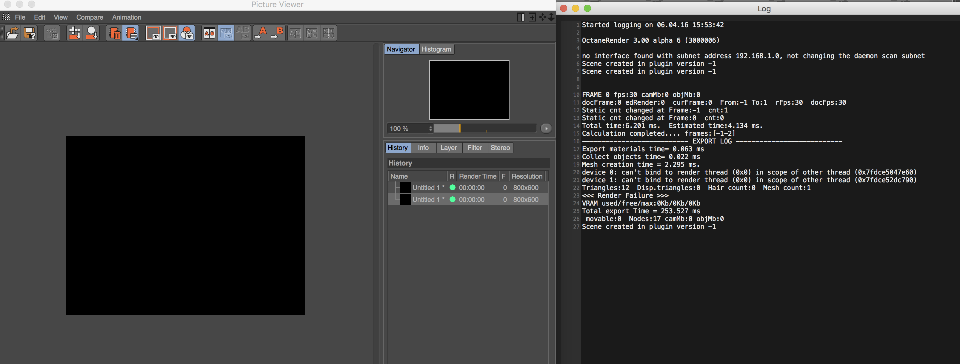

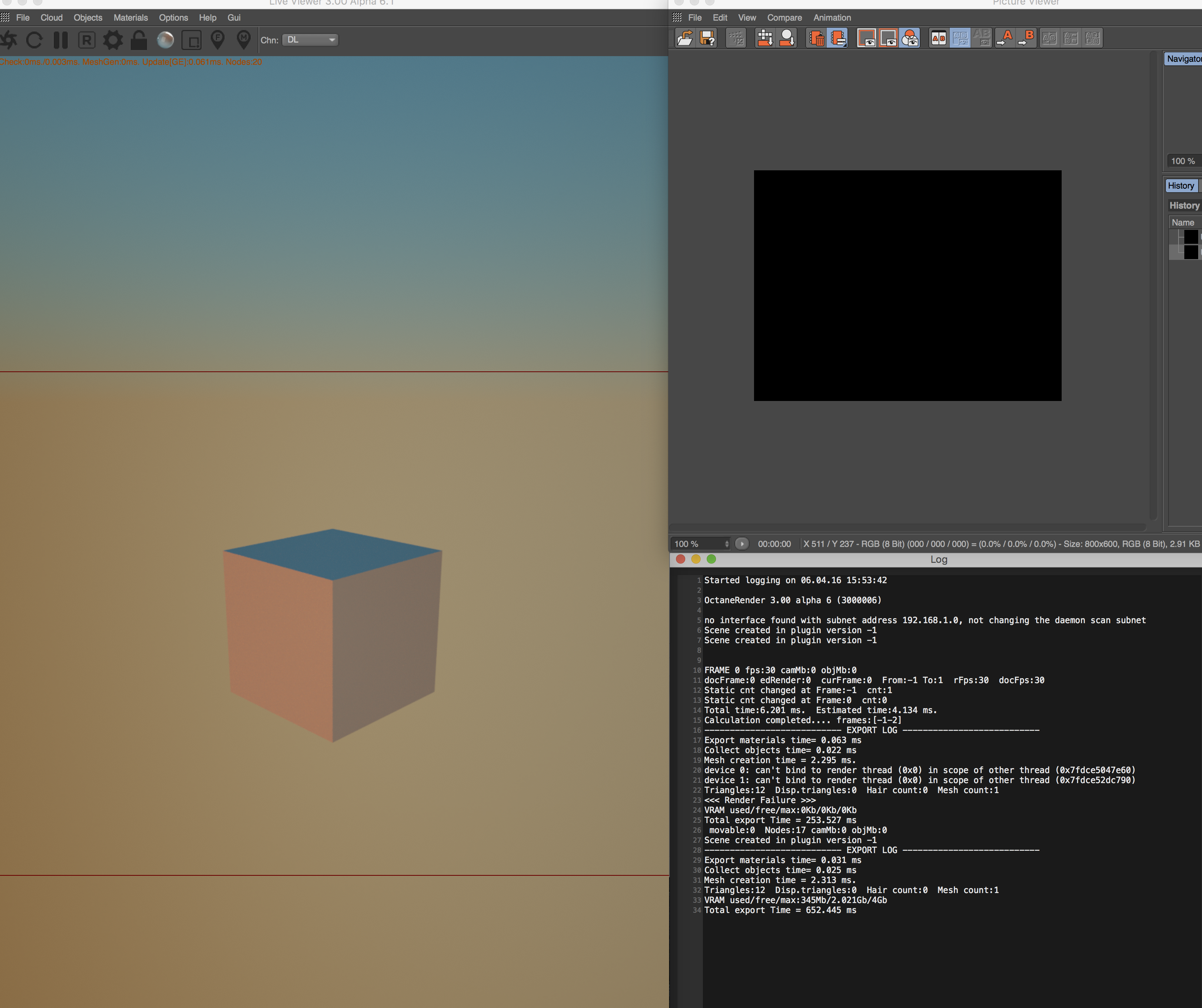

Thanks for the quick response, maybe that was a bad example scene. I have replicated the problem using a new scene with only a cube and octane daylight.
Same thing happens - Render to picture viewer fails unless I render in live viewer first. I've added screen grabs of the 3 steps I have to take to render to picture viewer.
Thanks for any help.

Step 3 - Render to picture viewer after scene is loaded into live viewer- Ok
Step 2 - Render to live viewer - Ok
Step 1 - Render to picture viewer - fails
