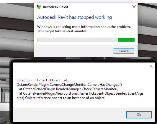

A new crash for your amusement.
Windows 10 Pro 10.0.10586 Build 10586,.
Revit 2017, Build 17.0.501.0 20160720_1515(x64) Service Pack 2.
OctaneRender for Revit 3.3.3.43.
GTX 960 (Octane)
GTX 570 (Displays)
Driver 372.54
CUDA toolkit 7.0.
The crash occurs when I change to a different 3D view in Revit. It's happened a few times, both with the current nVidia driver and the previous version. I am tight on memory with a big model.
I've seen this happen on other plugins. I think that when Octane is using a lot of VRAM, and you change the view, there is a brief moment when the host app (Revit in this case) requires more VRAM, which is not available, and the Nvidia driver or Revit crashes. Try turning on Out of Core Textures, and make sure the headroom is not too low. Also, using a separate graphics card as your Windows display adapter (which is not participating in the Octane render) will help with this.
