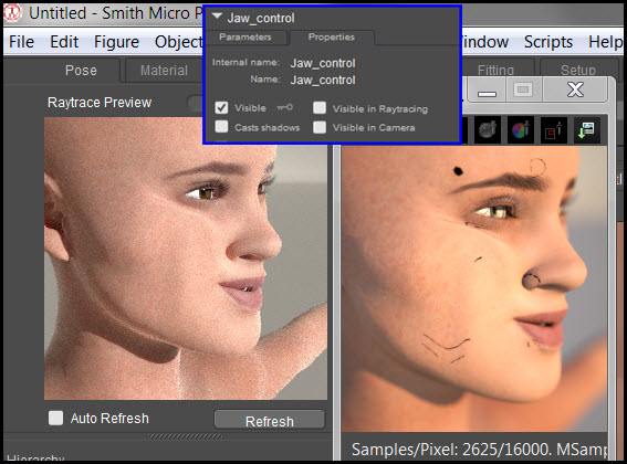

Hi Paul
O4P is rendering the default face control props (new rig feature of P11 characters Pauline and Paul)
Properties: they are set as preview-visible but not rendering visible by default
By default these props will get highlighted as cursor hover over face parts for direct on-mesh animation
Octane doesn't seem to register the unchecked Visible in Raytracing
Superfly is not rendering them (expected behavior)
I'm on SR2 11.0.2. Not sure if this happens with SR11.0.1 or from the start.
(I didn't play with face morph or expression when testing octane until yesterday)
I'm still on 2.24.
The workaround is turning off all 26 face controls in the viewport which will make them unselectable and unusable
or hunting for them in the drop-down body part list or hierarchy pane to turn them visible just so that one could select them and use them
then turn them off for rendering in Octane. Obviously not viable...

Can you pls give me an exact set of steps to reproduce this problem? Looking at the render, it appears the morphs are pushing the face vertices into each other, causing self-shadowing. Did you try reducing the ray epsilon? EDIT: I see the problem - the props are invisible, but penetrating the figures skin in some situations. I will try to figure a way for them to be ignored.O4P is rendering the default face control props (new rig feature of P11 characters Pauline and Paul)
That's correct. It uses the Poser Visible checkbox to determine the visibility of the mesh in Octane.Octane doesn't seem to register the unchecked Visible in Raytracing
Paul
I have investigated this problem further, and it looks like a Poser issue (and I have reported it as a bug to Smith Micro).
The workaround is to click the Poser->People->Pauline->Face Control->Control Handles Hidden.
I will investigate if there is a better way for the plugin to identify that the props are not to be rendered.
Paul
Paul
I have a solution for this now, which will be in the next TEST release.
Paul

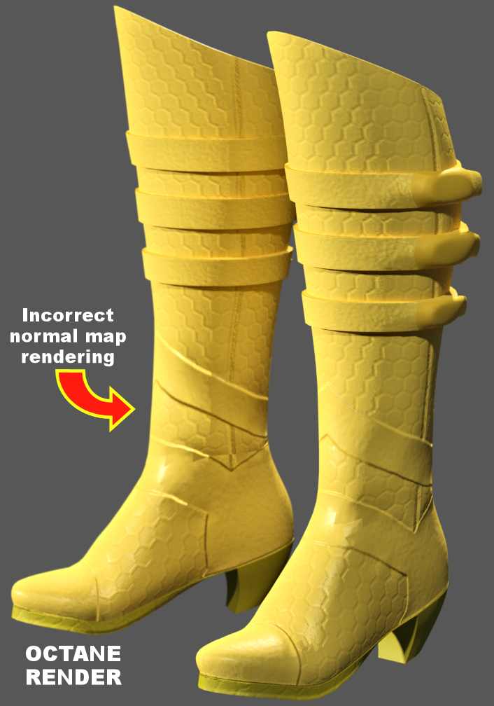

This week I have been creating a new conforming outfit and noticed Octane is rendering normal maps inside out when the model is mirrored. For example, the right foot of a pair of shoes is a mirrored copy of the left foot. The UVs are mirrored and overlapping, and that's where Octane is displaying the mirrored side inside out (UV normals are inverted). Firefly and Poser's OpenGL previews have the same issue with normal maps, but the new Cycles (SuperFly) renders them properly in all cases. Apparently it automatically knows how to handle mirrored UVs.
I imagine all pairs of shoes, boots and gloves in Poser are created with symmetry, so this is pretty common practice. It seems like a matter of flipping UV normals when they are mirrored and overlapping. In the attached image, the right foot is a mirrored copy of the left foot. The normal map in the right foot is rendered as inside out because of the mirrored/overlapping UVs. I was wondering if this could be fixed in Octane 2.x?
Yes, this has been reported before. It's an issue with Octane rather than the plugin. Can you pls report it to Otoy via the Octane Standalone 3 alpha 4 thread.This week I have been creating a new conforming outfit and noticed Octane is rendering normal maps inside out when the model is mirrored. For example, the right foot of a pair of shoes is a mirrored copy of the left foot. The UVs are mirrored and overlapping, and that's where Octane is displaying the mirrored side inside out (UV normals are inverted). Firefly and Poser's OpenGL previews have the same issue with normal maps, but the new Cycles (SuperFly) renders them properly in all cases. Apparently it automatically knows how to handle mirrored UVs.
