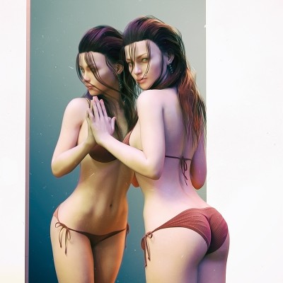

Looks nice. Like the glint in her eyes.Notiusweb wrote: 500 s/px

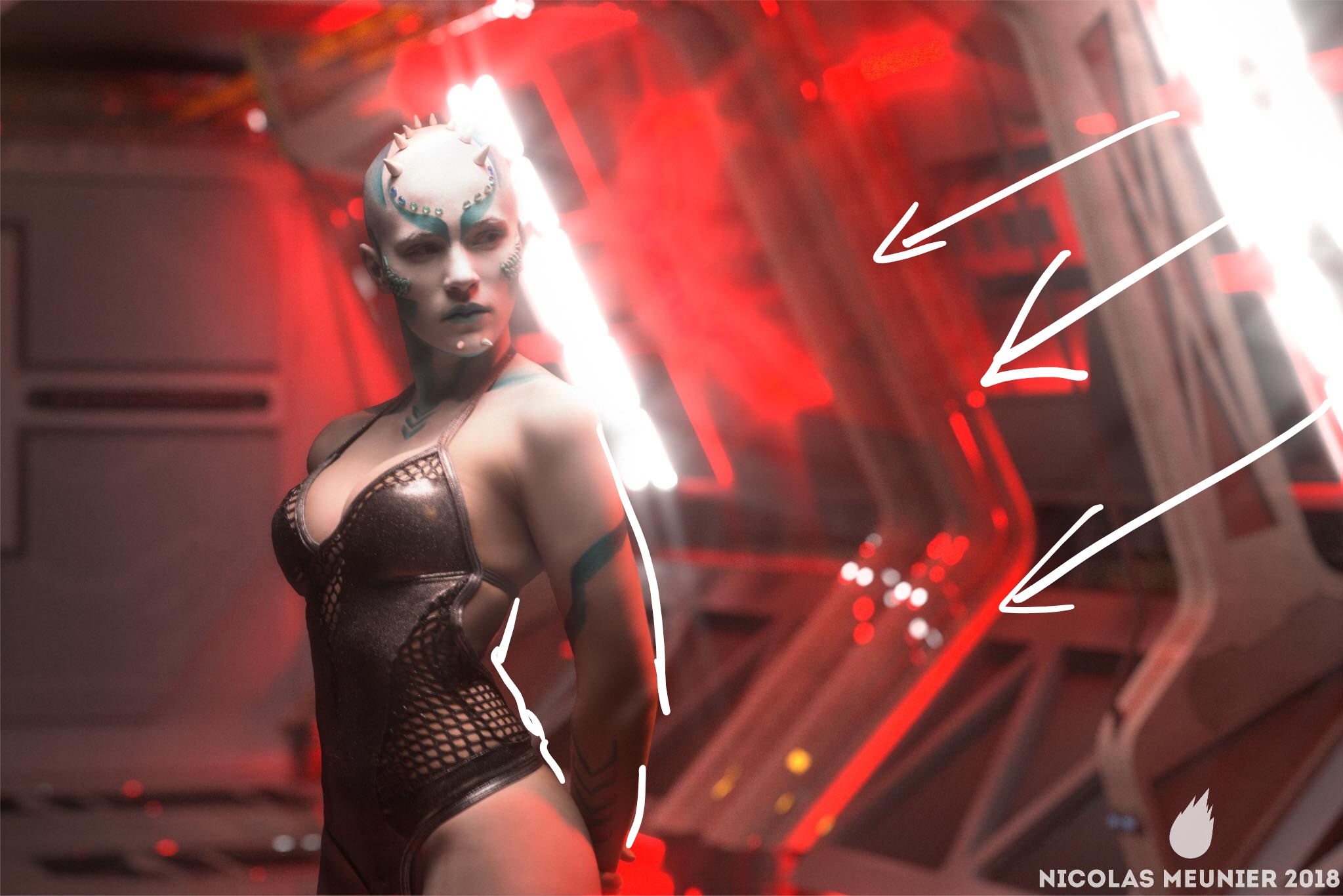

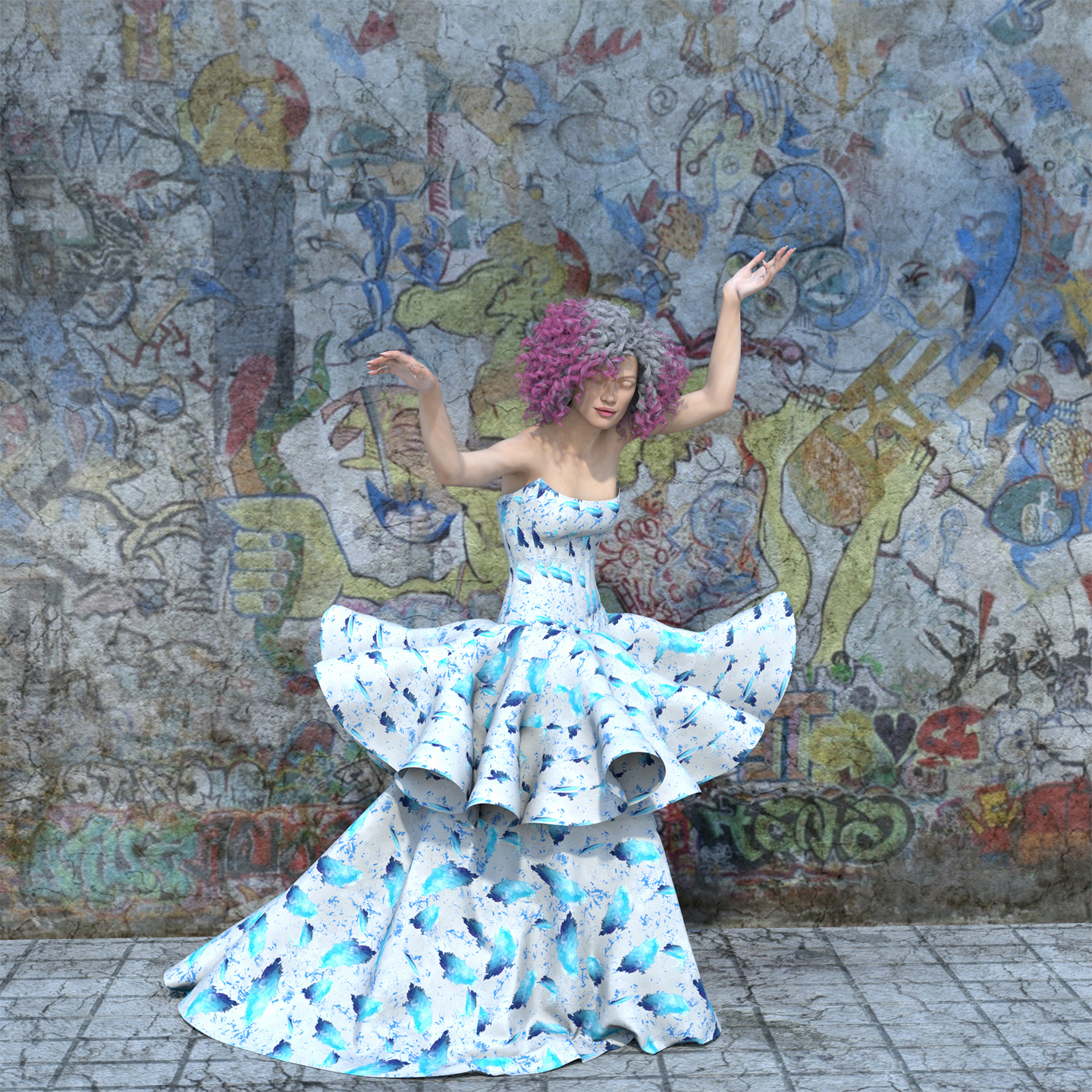

Hello!
I'm a photographer and my goal is to include my pictures of model shot in studio into 3D sets.
Here is my very first attempt with DAZ and Octane.
I have placed a plan into the 3D with my pictures as a textures (with Alpha)... and I have tried to make it perfect without having to go into Photoshop at the end... so everything is direclty the result in Octane.
The journey will be VERY logn to make what I want, but the first step looks promising.
Regards
Nicolas

Very nice. Like what you have done with your model. A little les DOF would be good also. Good first try check your lighting without photoshop or some way of transferring the environment light on your model it looks a bit off. Pardon the image repost to illustrate the point.

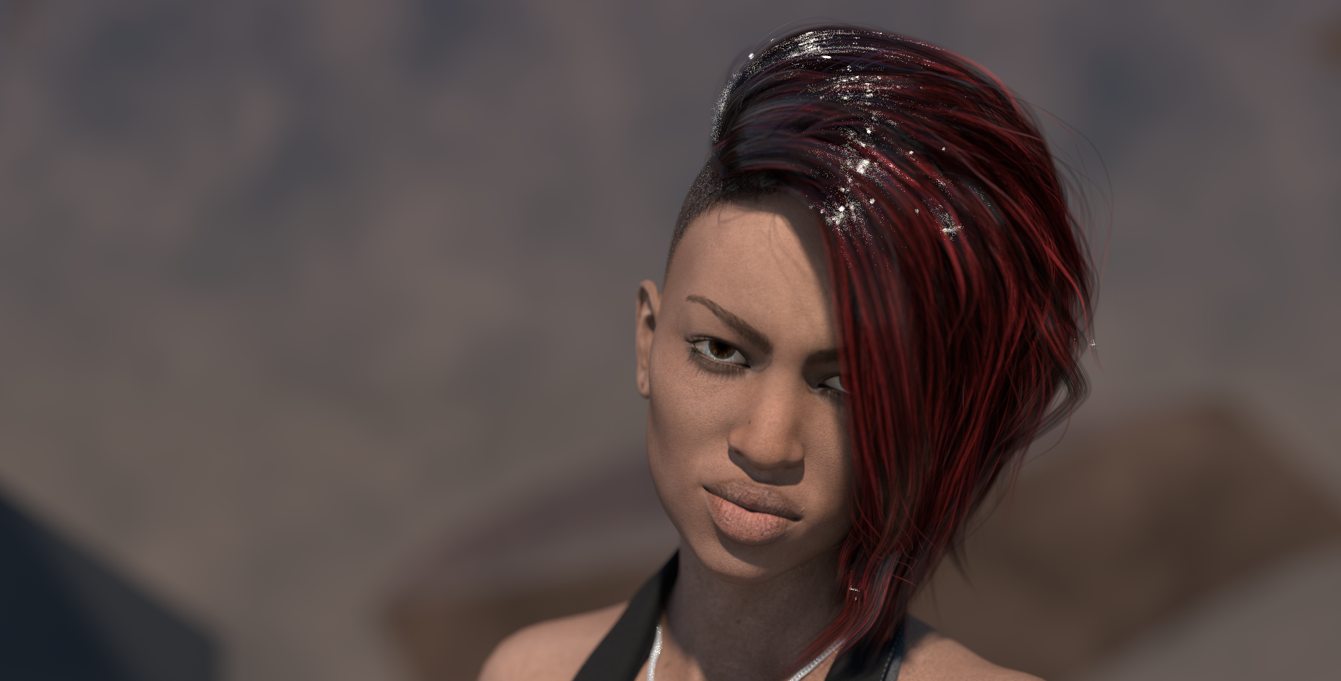

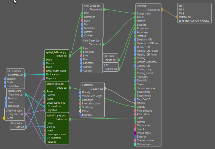

Welcome to the Daz Octane forumvbrabble wrote:My First Render from DAZ using Octane. Now I need to figure out what is going on with the hair. I am blown away with the realism though.
Any tips, guide or tutorials to optimum settings would be appreciated.
VB
Once you get familiar with the above settings, then you can explore using a specular material mixed with a diffuse material and glossy material to add SSS (sub surface scattering) to the hair to make it look more realistic. You will need to use the Medium node and add absorption to the Diffuse node and scattering to the specular node. You can turn on the Fake Shadows in the specular node otherwise your render will go on for a lot longer. You can search for tonysculptor hair (or just hair) in the LiveDB to get a start. The more you experiment with the settings the more you will know what effects what in the render.
One last thing, if you hair has many surfaces, you will need to do the adjustment for each of the surfaces. You can copy materials from one layer to the other, but you may need to change the diffuse / bump / opacity / specular / etc maps back to what they should be for that layer. Copying material will copy the current maps overwriting the existing maps of the other layer. There is something called templating that will help you keep the original maps in the layers, you can search the forum for templating / template to see how to do that.

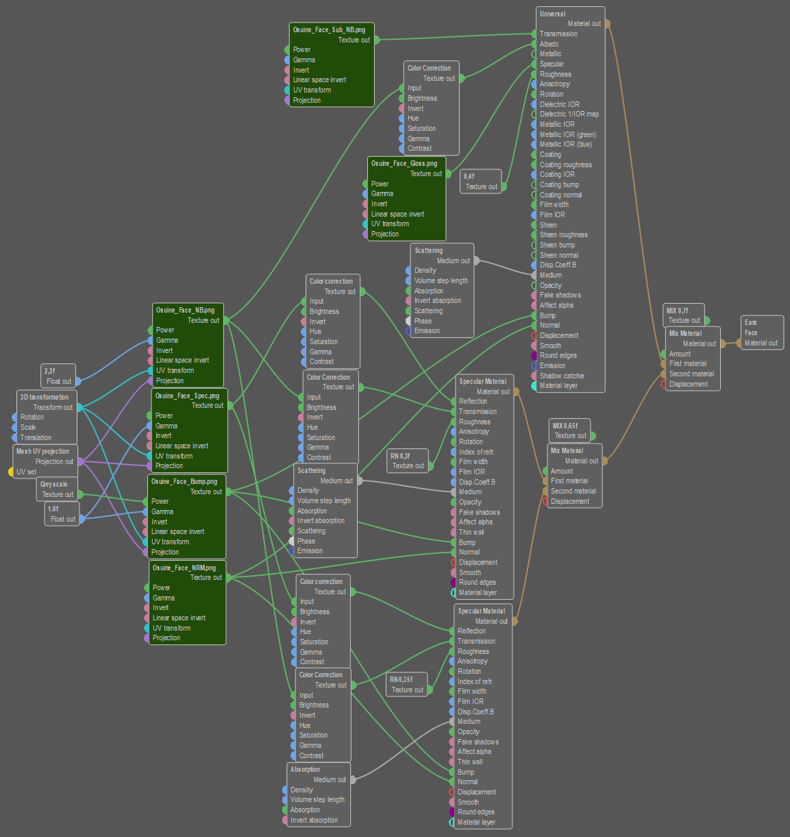

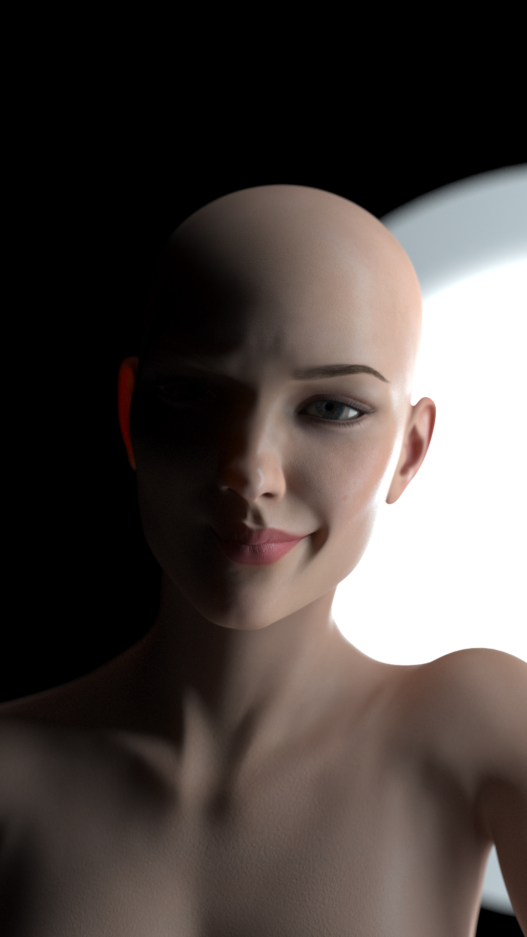

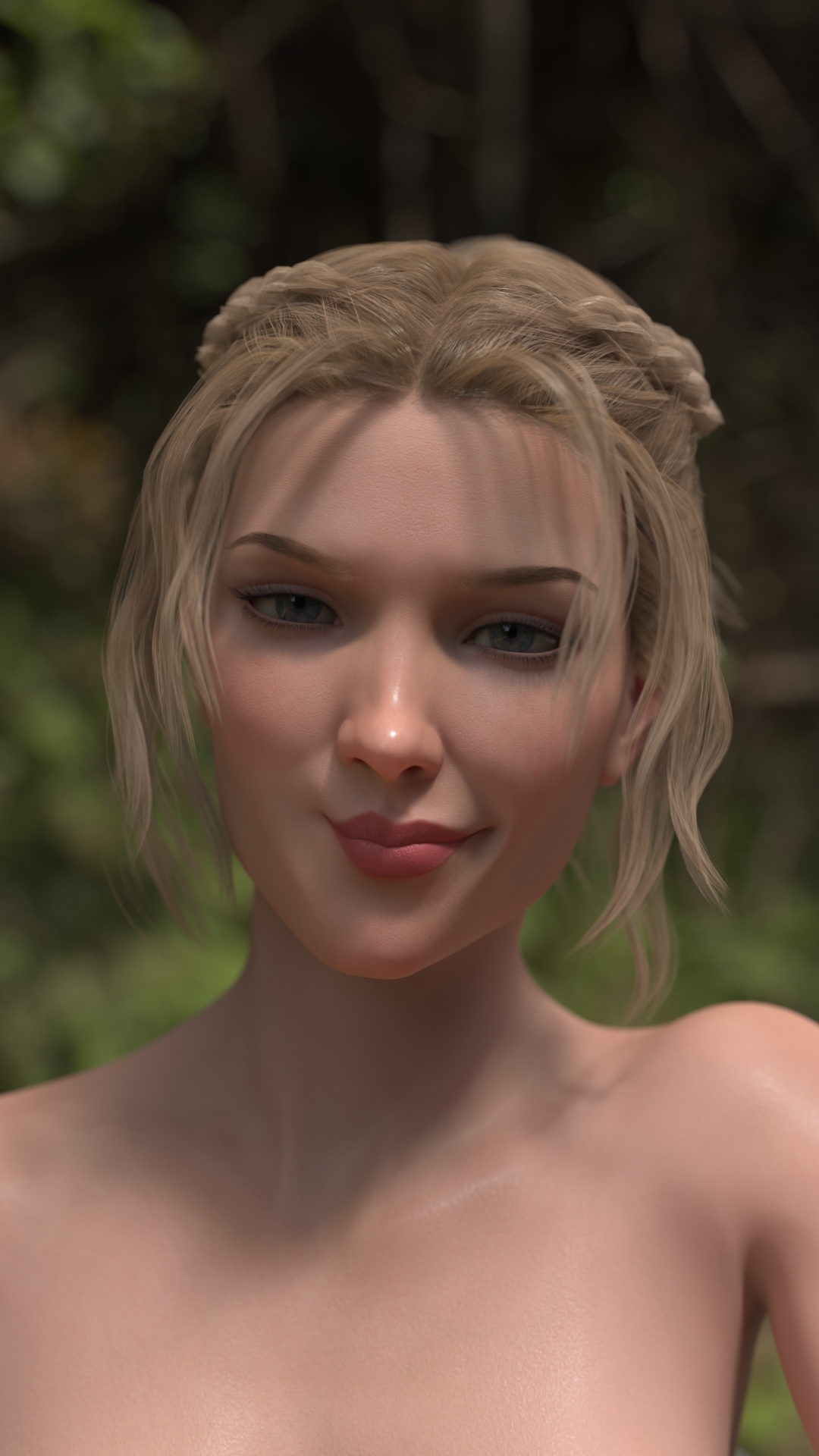

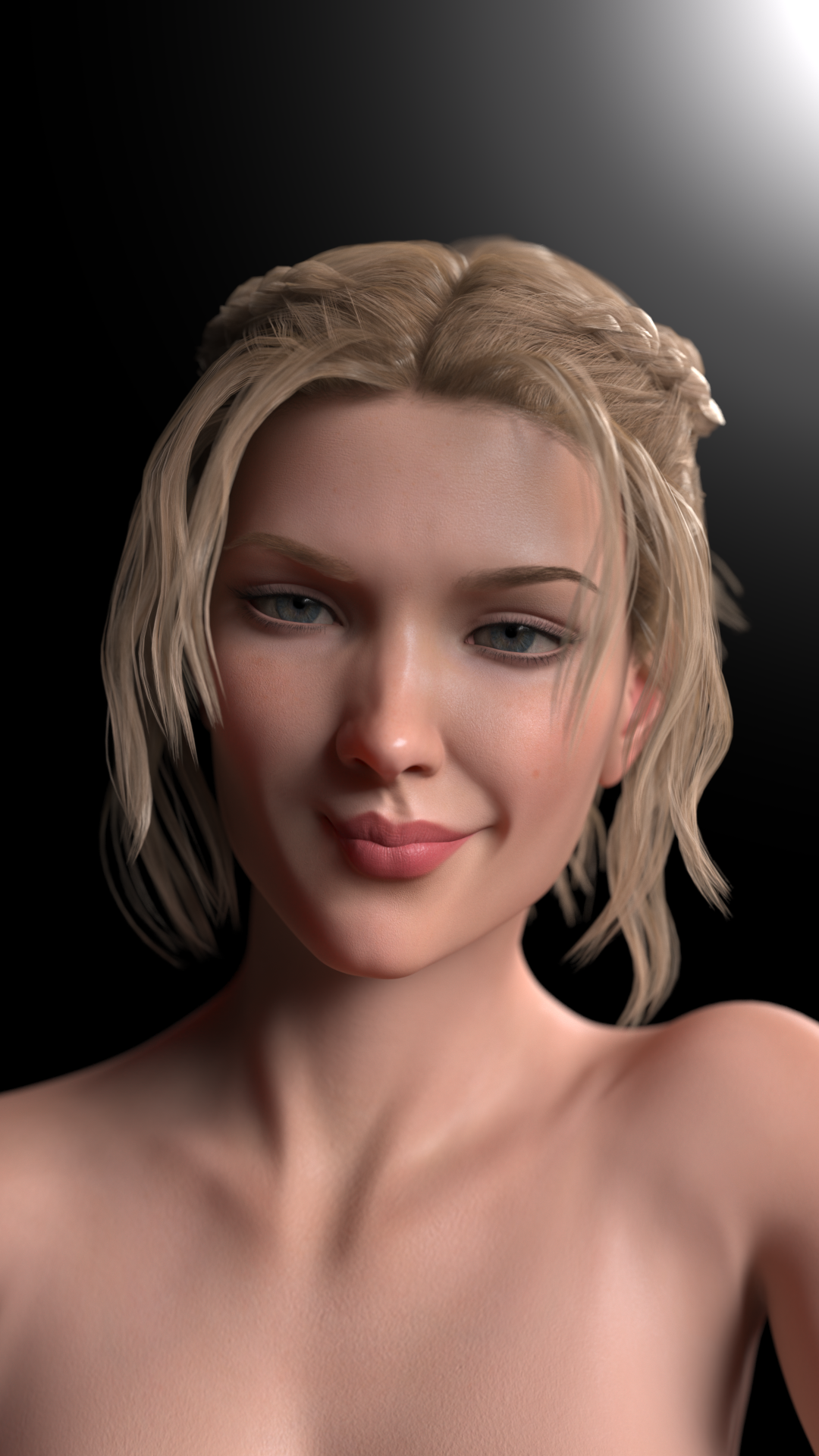

i'am trying to work on my own skin shaders and would appreciate some advice. I started messing arround with the redspec shaders and the tony sculpture shaders. Both are really great but have some disadventages in my opinion, for example the bluish fresnel like effect on the redspec shaders is to strong in my taste. So i started messing arround on my own and going slowly in a direction i'am happy with but there are still big problems i guess. I guess i'am already working to long on them to see everything wrong anymore, so i would appreciate if someone could point out some things and give advice if possible.
One thing i can't manage to achieve is really glowing ears without messing up the rest. For example in the first picture. The left ear is pretty much glowing unlike the right, which looks way to diffuse in my opinion, even if there is a really bright light source directly behind it.
On the second and third picture i'am kinda confused why the right eyebrow appears darker in a more lit area than the left one.
I'am wondering why there is no transition on the forhead like on the nose. I'am aware it wouldn't be that strong, but i expected at least a little transition. I think a skeleton below the skin, that would reflect light from the inside would help. Does someone know if the "V3 & M3 Skeletons (Upgrade from Skeleton)" from the Daz3D Shop could be transfered to a G8 female and if it could improve the overall look and feel of the skin?
Another thing that is giving me a headach are the colors of the skin and the hair. I'am not sure if the overall tone of the skin is to redish. Does the skin look to much like wax?
I'am working for quite some time now on this shader and maybe i lost myself in it and can't see obvious problems anymore. It would be nice if you could point out some things i have to take more into.
I attached the shader setup aswell for a little bit more insight.
Kind regards.
