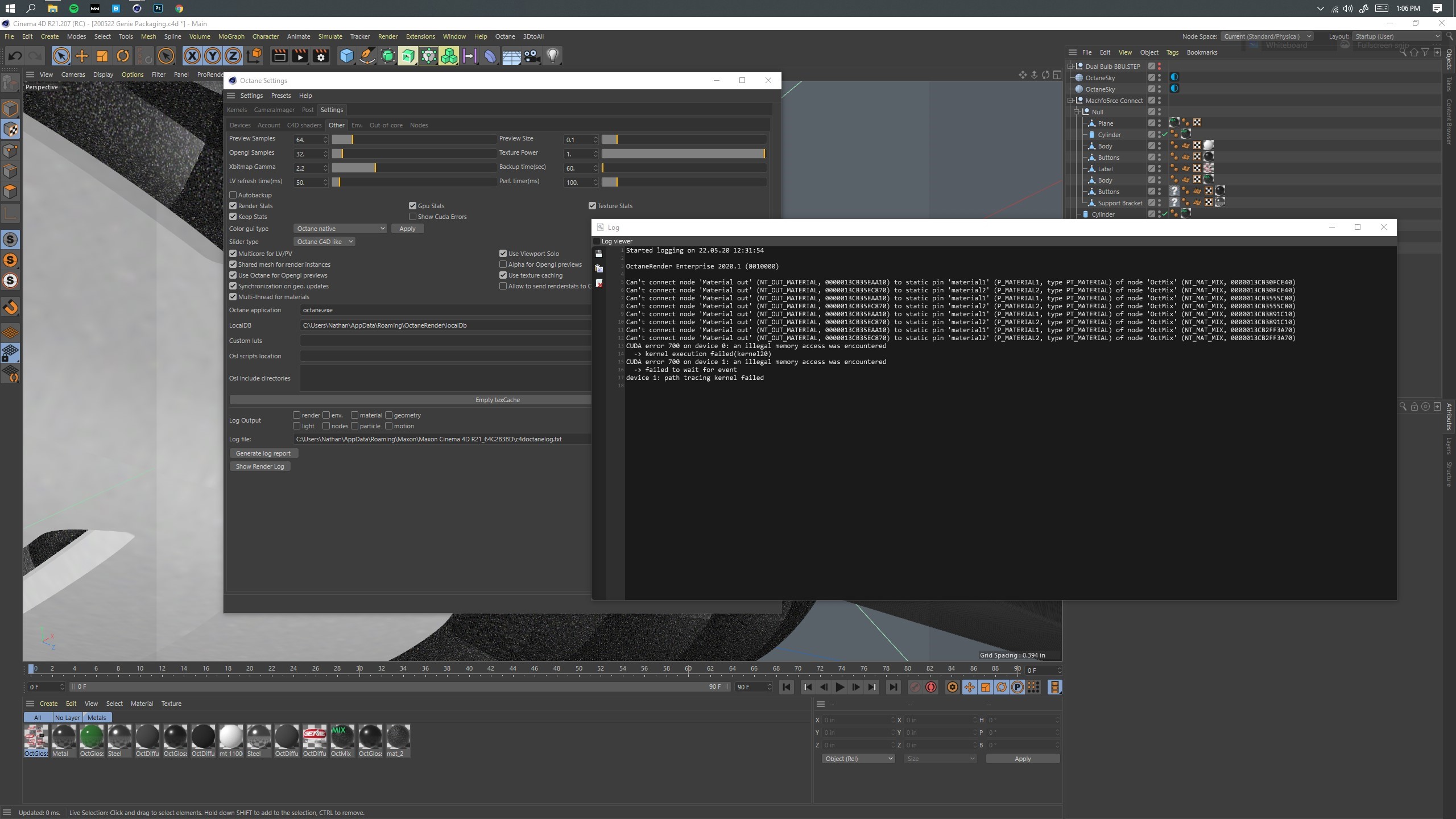

Follow up:
Reinstalled Octane, Cinema 4D, and DDU Nvidia drivers.
Rendering works fine with only 1 GPU enabled. When i enable my secondary GPU, I get crashing.
Same error as above happens when I have an empty scene and hit render.

Better to look for issues on your GPU/PSU and drivers.ndreimi wrote:Follow up:

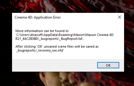

Hi Ahmet, i get crushes every 3-10-20 frames at randome time on my new project. What could be the problem?
Scene with only x-particles objects: Particles, OVDBMeshers.
I sent the scene file to your pm. Simulation takes a long time. The scene contains 3 particle systems, each of which has its own catcher object.
OctaneLog, Octane BugReport, Cinema BugReport
https://yadi.sk/d/vjsolUAFaOMz9A

Hi Ahmet, is there any information about my problem? I was forced to switch back to rs again in this project, because the octane was again inoperative.
It's holiday here and caching takes hours. No time for this.divasoft wrote:Hi Ahmet, is there any information about my problem? I was forced to switch back to rs again in this project, because the octane was again inoperative.
I was hoping you could extract some information from the error reports.aoktar wrote:It's holiday here and caching takes hours. No time for this.divasoft wrote:Hi Ahmet, is there any information about my problem? I was forced to switch back to rs again in this project, because the octane was again inoperative.
