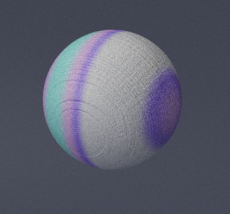

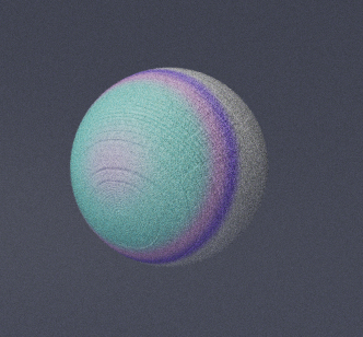

Hi aoktar,
I have detected a problem on the last release R6.2. 2.23.2
I use the octane gradation and the result given by the Live viewer is not at all the same as that of the final.
An idea of the problem?
Live viewer
Live viewer
Live viewer
Capture d’écran 2015-08-03 à 09.46.49.png (209.76 KiB) Viewed 6149 times
Engine render
Engine render
Engine render
Capture d’écran 2015-08-03 à 09.47.06.png (222.15 KiB) Viewed 6149 times
Thx;

r4dn wrote:Hi aoktar,
Live viewer
Engine render
Thx;
Put object tag and switch to "Resend only updated objects" and check manual and support section.

Posts: 16068
Location: Türkiye
Live viewer
Engine render
Thx;
It's only possible when you use OBJECT BASED TRANSFORM + MOVABLE objects. And LV makes all objects AS MOVABLE by DEFAULT. But if you use a method which causes that OBJECTS ARE UNMOVABLE, so this transform node will be lost. Best to understand what i mean, thanks.
