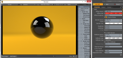

If what you say is true, why does the ball render black in the attached render?That really isnt going to work. Look at the sample scene I sent you which has spec 4% and conserve energy on. Your new rule would render the ball black instead of green.
Paul
Because you have spec set to 100%

OK - I have reflections at 4% (see the screenshot), but I clicked and unclicked Match Specular and it changed to green. So something amiss with Modo there which has me coding the wrong rulesBecause you have spec set to 100%
If spec = 4% diffuse will automatically = 0 (black).
EDIT: If you check the screenshot - you'll see reflections are at 4%.
