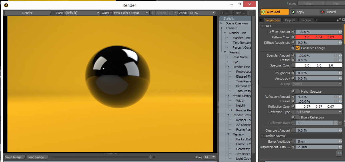

If what you say is true, why does the ball render black in the attached render?
Paul

Because you have spec set to 100%
If spec = 100% diffuse will automatically = 0 (black).
The issue here is that modo is not a physically accurate render by default and uses tricks (specular highlights which are really reflections) and splits the controls for spec and reflections.
You cant do this in octane because it is physically accurate
If spec = 4% diffuse will automatically = 0 (black).
OK - I have reflections at 4% (see the screenshot), but I clicked and unclicked Match Specular and it changed to green. So something amiss with Modo there which has me coding the wrong rules :-(
EDIT: If you check the screenshot - you'll see reflections are at 4%.
