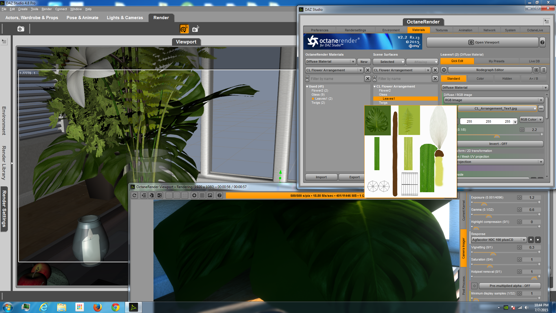

Here's one, OR seems to want to take the whole 'leaves' .jpg into the render, whereas Daz somehow is able to set the non-leaf component's opacity of the image to 0.
None of the parameter sliders in leaves materials help reduce the 'green screen' opacity
Leaves have the .jpg's square background in Octane Render
Thoughts? Thx!

Notiusweb wrote:Here's one, OR seems to want to take the whole 'leaves' .jpg into the render, whereas Daz somehow is able to set the non-leaf component's opacity of the image to 0.
Thoughts? Thx!
OcDS doesn't convert Iray materials very well. So you need to set opacity maps manually.

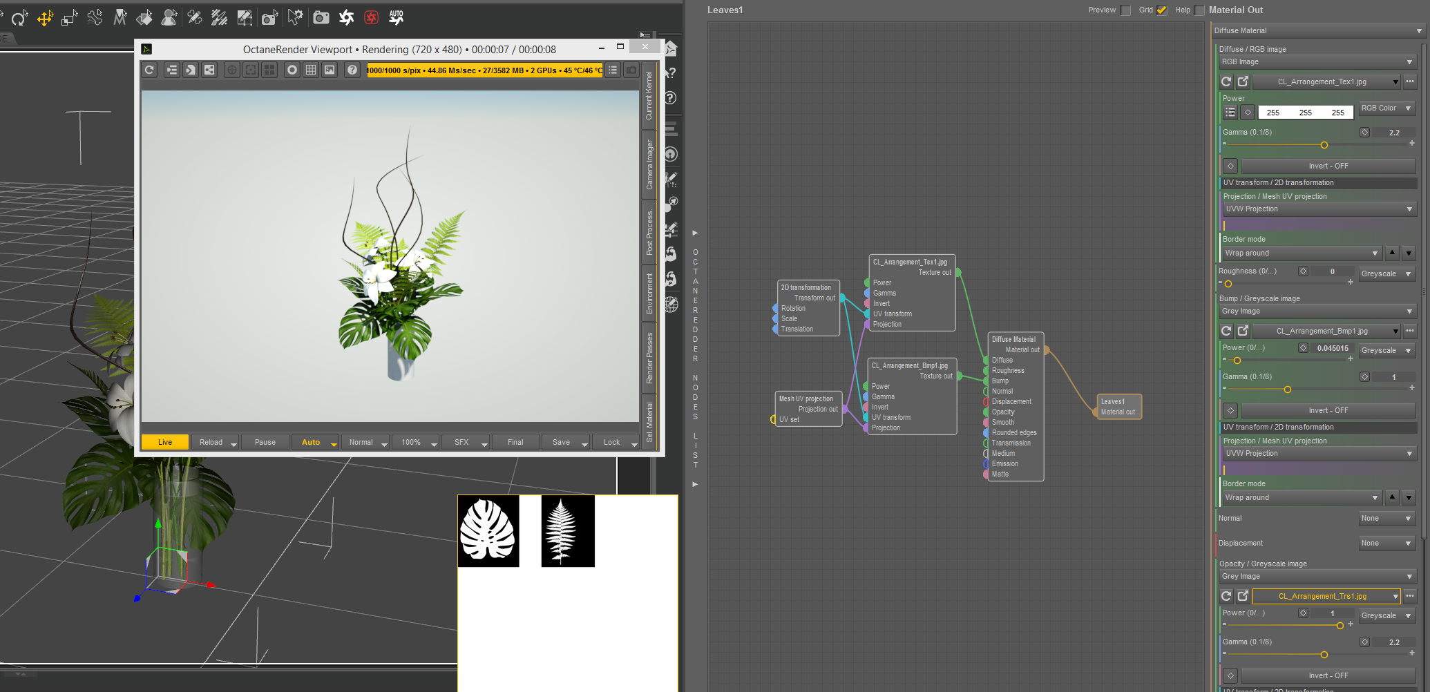

Awesome!!!! Thank you so much!!!
Opacity from Greyscale, to Grey Image... + Bonus Elephant
