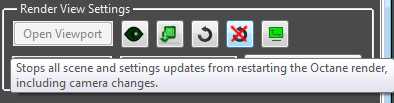

Stop scene update.
If I want to add and delete stuff from the poser scene but leave octane open for when I want to render it to see what it looks like, why does the "Stop all scene and settings update...." switched off work.
With a big cross over the icon, the scene still updates between changes.

Stop scene update.
Fixed in the next release.
