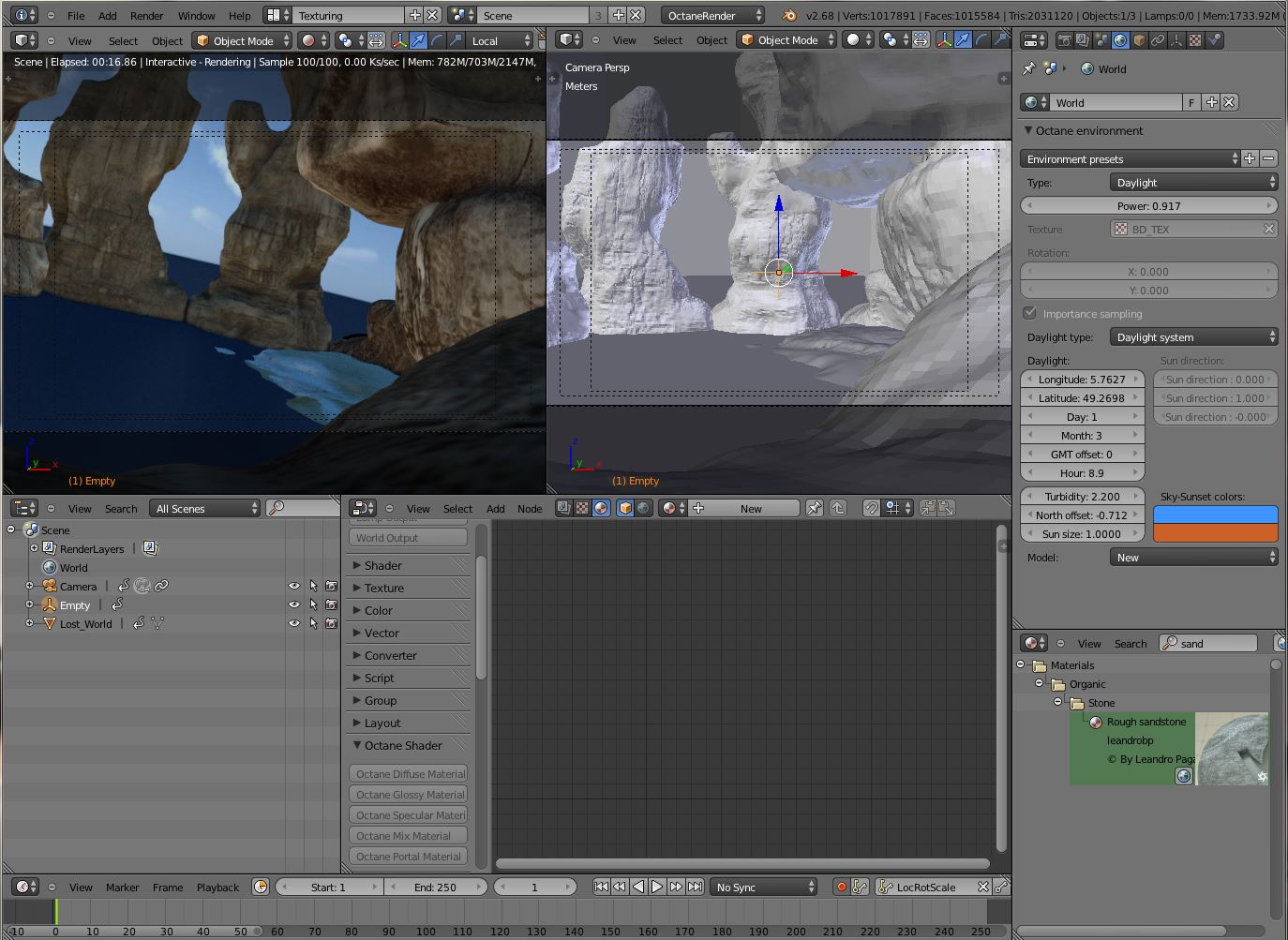

This is the only project it has happened in (so far) but am currently having a rotation issue with the render view not matching the camera view! I am looking in to it right now but thought it worth seeing if anyone else has had this problem? Due to the Cam being tracked to constraint (empty)?
Thanks ;)

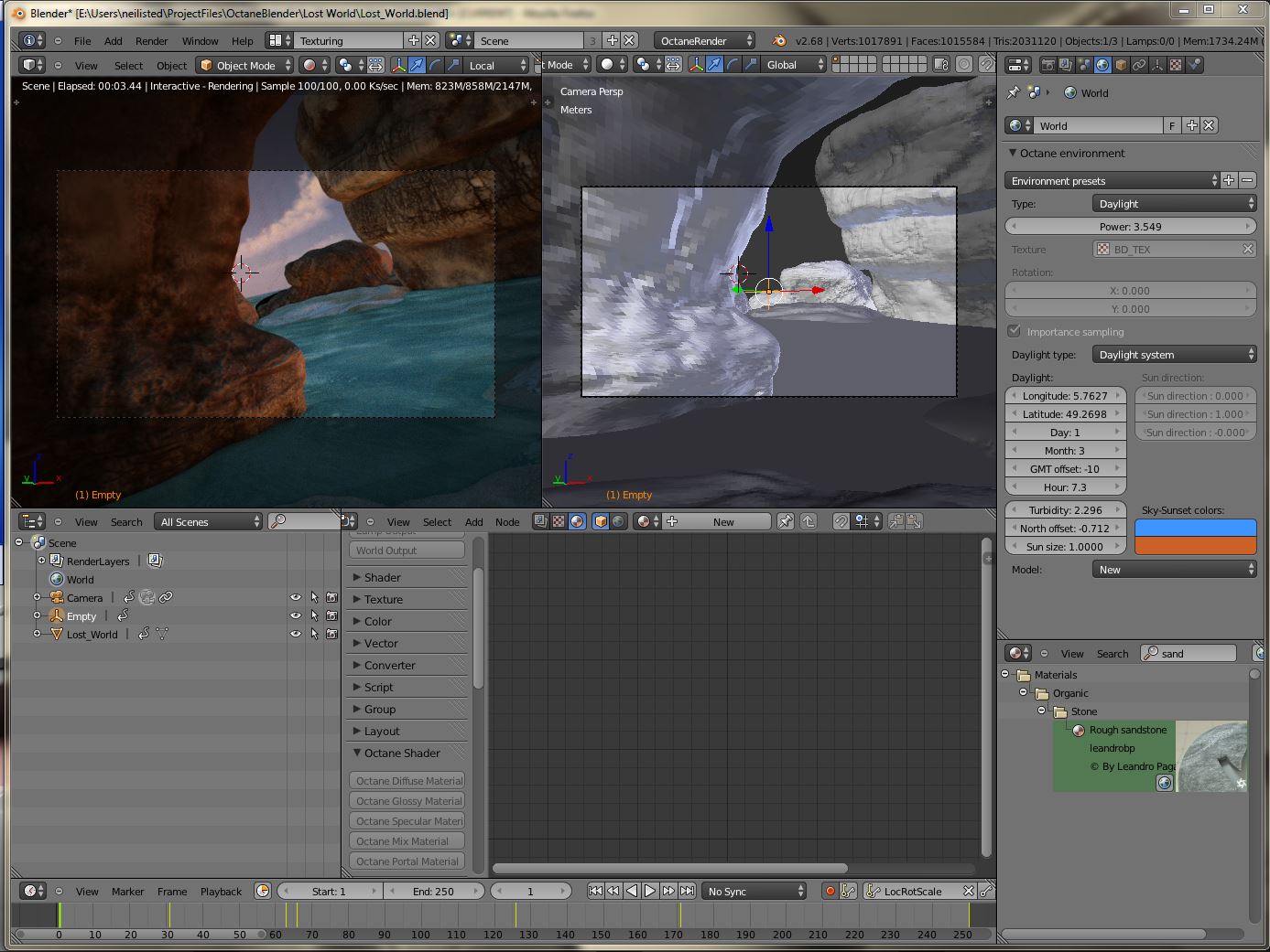

Only render window effected ! viewport cam stays with correct alignment BUT when moving cam or empty the render view ONLY (!!!) goes out of alignment!
Cams not matching render window!
Messing with Axis/empty location...
Server crash!
Server crash!
Well, apart from server crash (not sure about that!, you need a server log?)  I am not sure what to do, if it was user error then surely both cam view and render view would have the same alignment error Right?

For "live-view" rendering mode you should compare the camera of the same viewport window, not the different windows. As you have absolutely different size and aspect ratio of different opened viewports (or camera and opened live-viewport), and the Octane's "live-mode" recalculates the camera's view-angle to fit in the current viewport size and aspect...
So, the right way to be sure that it is the bug or not - to compare it in the same view, enabling-disabling the live mode and looking at congruence of the Blender-viewport image and the image rendered into the same viewport by Octane...
Or render in the "F12" mode and compare this rendered image to Blender's camera view...
