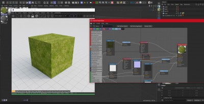

It has problem with updating scene nodes, capsules too :
oct_nodes_update.zip
(1.64 MiB) Downloaded 125 times

SSmolak wrote:It has problem with updating scene nodes, capsules too :
Same answer will go to you also

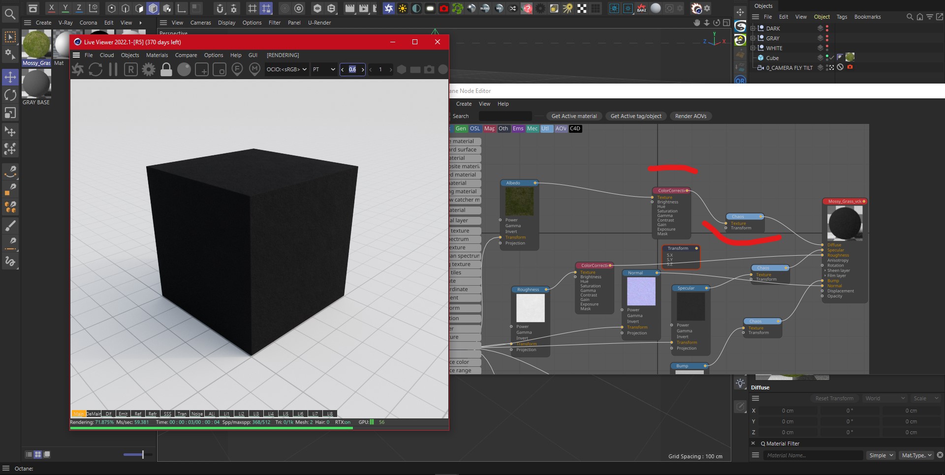

modify material type, some problem.
I didn't know this is octane setting or bug?
version: 2022.1-[R5]

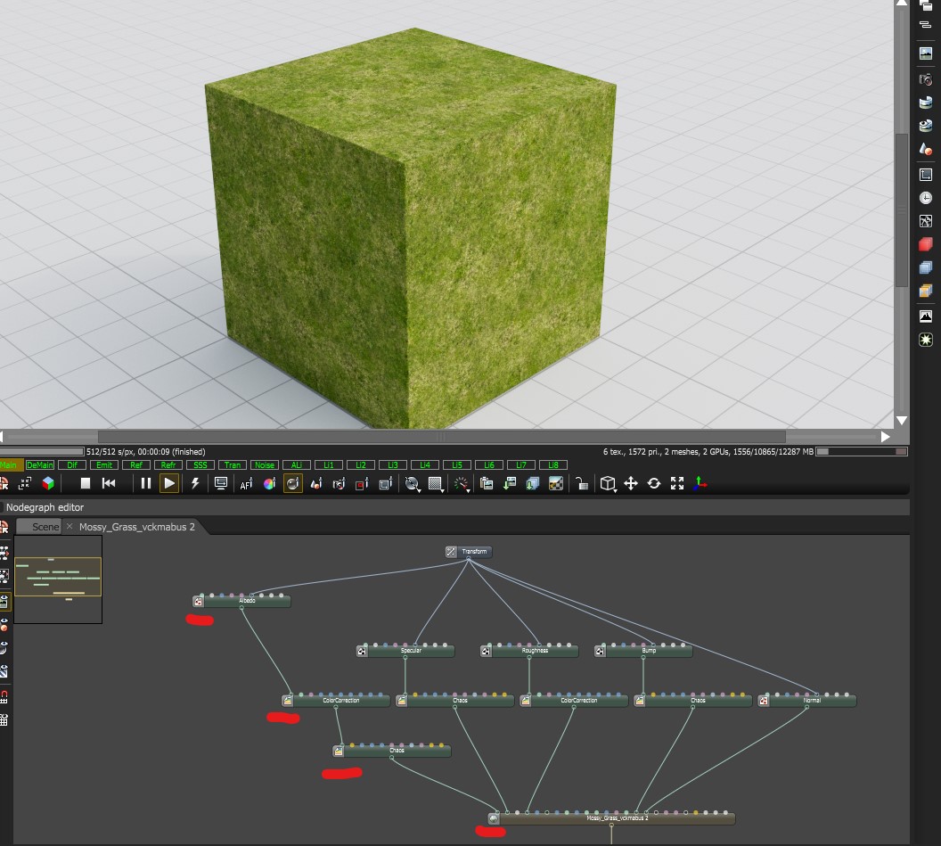

Is it normal to have the "Chaos node" to behave very differently if placed before or after a "Color Correction" nodde?
Don't remember seeing this difference on earlier builds. On Standalone we don't see this problem.

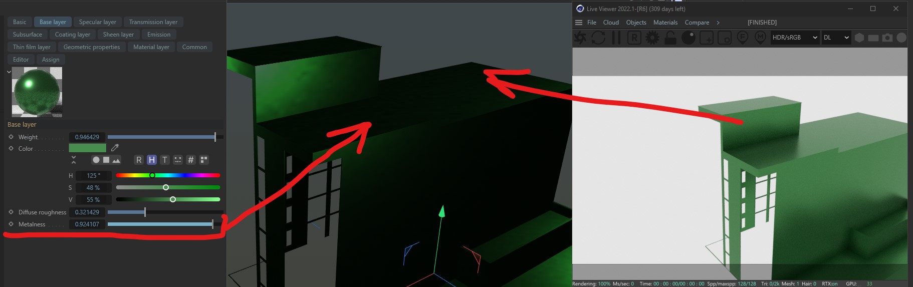

Material viewport display issue using standard material and metalness parameter :
If object doesn't have uv map it display fine in uv material projection. But other projections flat, cubic still have this issue.
Architectural Visualizations http://www.archviz-4d.studio
Posts: 16068
Location: Türkiye
SSmolak wrote:Material viewport display issue using standard material and metalness parameter :
Don't know what you're assuming here but there's not any capability to write/develop the shaders for viewport materials. We just render a flat plane and apply as diffuse. Maxon never provided any example or sources for doing something better.

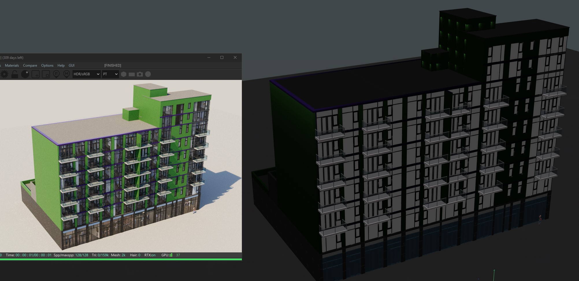

aoktar wrote: Don't know what you're assuming here but there's not any capability to write/develop the shaders for viewport materials.
I'm not report that this should simulate metallic material but it lose color in viewport - materials are totally black. It's better to have plain color than black.
Strange that I didn't noticed this before but in all other material types, universal... there is the same view issue :
Problem is more noticeable if we have one large metallic material like this :
All building is black in viewport because of metallic panels.
