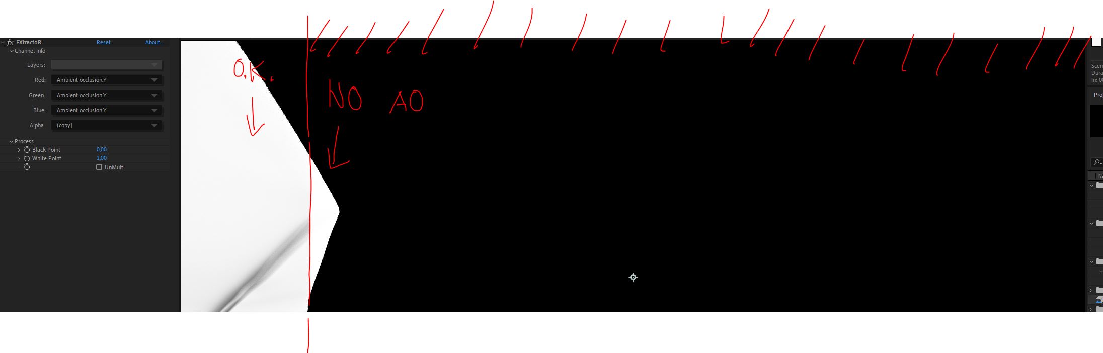

Hello Ahmet,
please could you check this!
When rendering EXR/EXR-Octane Passes the AO-Pass is somehow wrong.
It renders only a bit on the left side. The rest is completly white.
Happens here in Version 2020.1R2, R3 and also R4 within my current project.
thank you!
regards
Mike

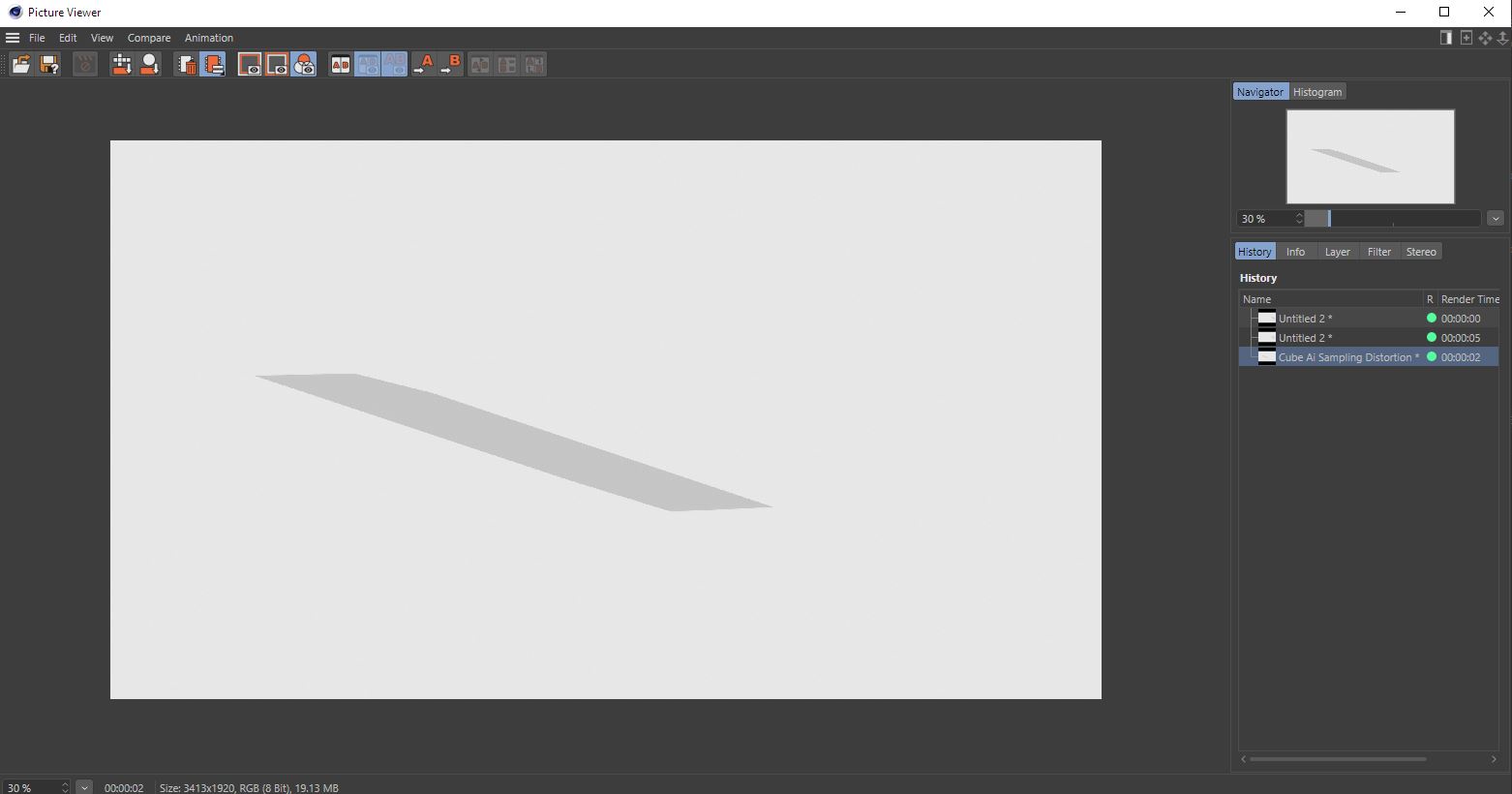

aoktar wrote:
Aleksei wrote:If in Octane camera tag I turn on sampling mode the image in the viewport gets distorted.
Cinema 4D R19.068 on Windows 10.
Sample scene required, I cannot repro it
Not sure if the issue has been resolved yet. I'm also experiencing a similar issue with the upsampling option when turned on. The final render always results in this skewed distortion. It even happens when I tested it with a simple scene.
Running on 1x 2080ti and 1 x 1070ti cards
Cinema4d R21.115
I can't seem to upload the file so I've attached a download link instead.
https://we.tl/t-uMU0CklXiS
Thanks in advance for the assistance.

hellbydante wrote:
Cinema4d R21.115
It's fine if you set width=3414 instead of a weird value(3413.333).

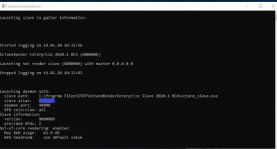

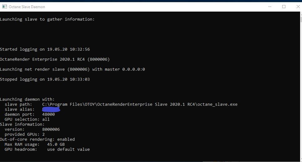

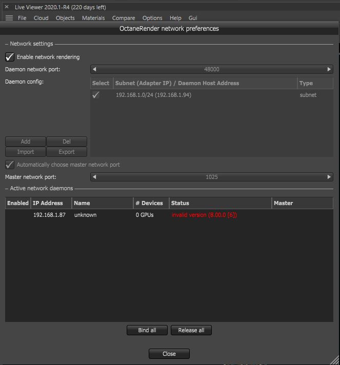

Network rendering isn't working with this version and the latest RC4 version slave daemon. Any known issues about this? My setup didn't change at all and it worked flawlessly with 2019. Latest drivers on both machiens.
Edit: see attached screenshots:
Edit: nevermind, my mistake. Got confused with the RC4 ending...
6850k // 32 GB // 1080, 1080 Ti, 2080 Ti // Win 10 // C4D 19.068
miohn
Posts: 783
Joined: Sun Jun 06, 2010 3:00 pm
nobody else having this problem with AO-Pass?
When I render the AO seperately via Infokernel, all is fine!
So I see no reason, what could be wrong with my scene.
Hope for some support, because rendering all twice is very time consuming.
thanks
Mike
