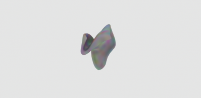

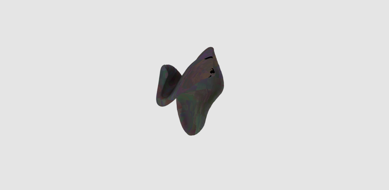

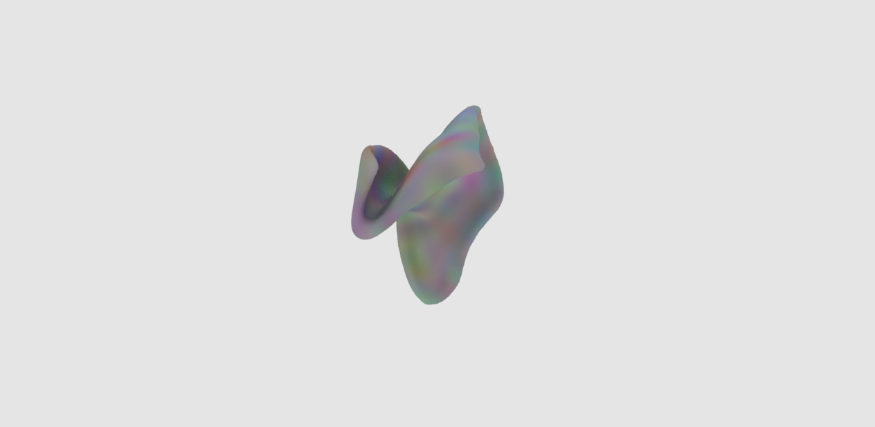

aoktar wrote: Could you send me a scene so?
Sure - here's a scene and three example pictures. First and second are rendered with V4, third with 2020 trial. It's not crashing all the time, but it's definitely not looking how it's supposed to.
Thanks for your help, ahmed!
It will be correct if you resend the scene. Problem here that geometry and material is not getting updated on next frame. Because there's a hacked way to obtain vertex map simulation in 4.05. It's working very well for 2018/2019/2020, because they have real support for vertex attributes. And it happen on just geometry data level, no need to refresh material with fake way. Unfortunately I stopped to work on V4 because I cannot keep working on many different versions together. It's not forcing the users to update new versions, it's technical problem on me.

Gregor.Zimmermann wrote: Thanks for explaining. So, in order to get it working the right way, I need to upgrade to 2020, right? Or is there any chance that this issue will be resolved in a future version of V4?
Probably I couldn't explain it well, answered this topic in past also. I stopped to work on V4. Restart and render on next frame it will be correct.
