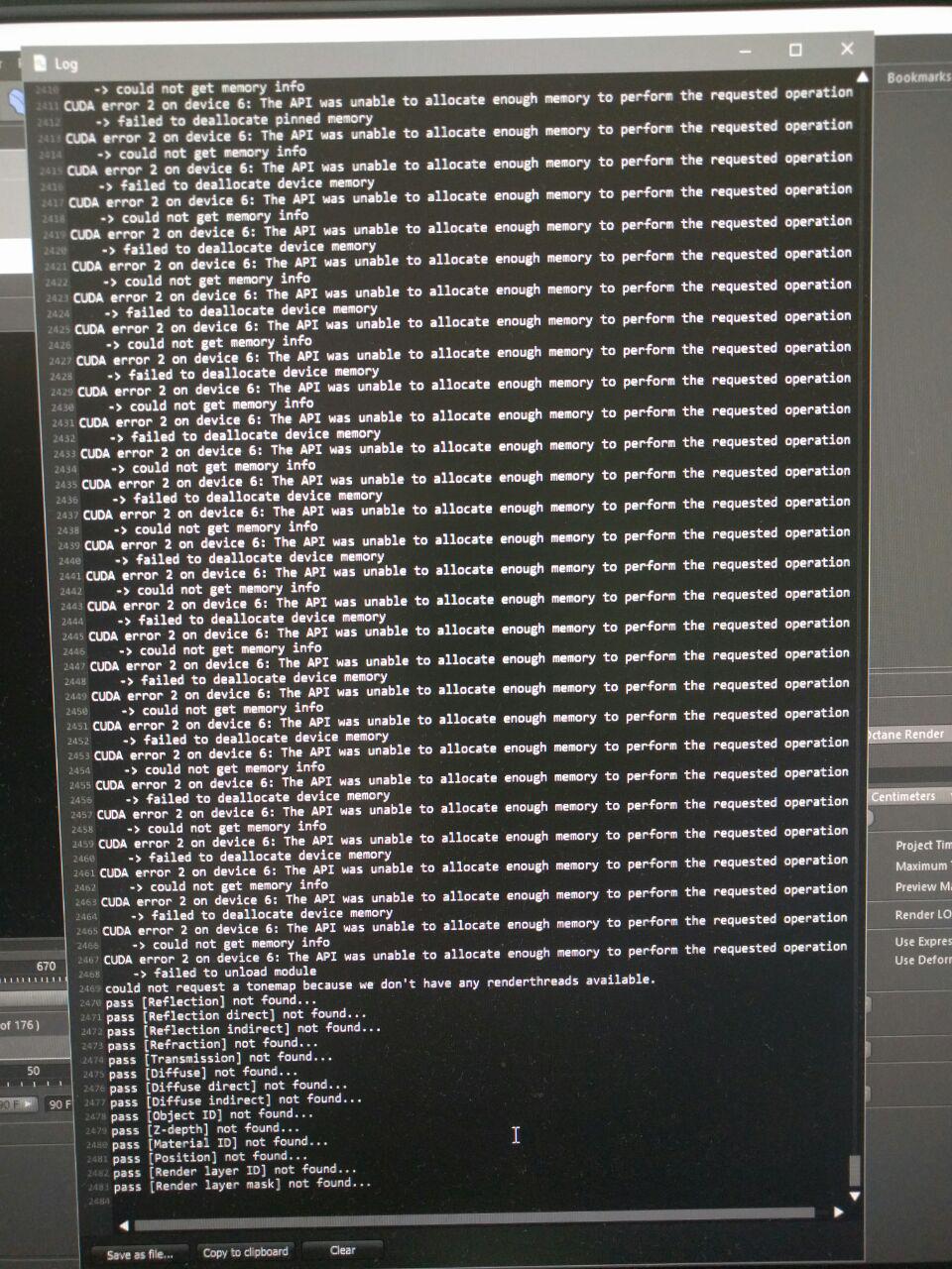

Sorry for long wait for an answer.
I read about lanes and see Smicha's build, and understand where is bottle neck.
But i still have problem(
I use 2 amfeltec clusters: 1 card inside and work on pcie x16, and another 7 outside and work on x1.
If i send scene from cinema4d to render just to inside card -- it's working good.
But if i send scene to all cards -- appear errors and and computer completely freezes.
What could it be?

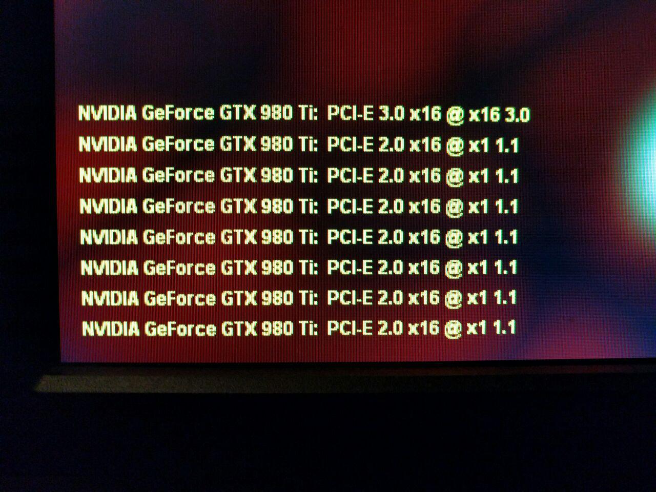

I maked these!
