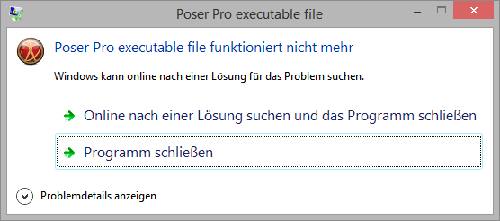

when I exit Poser normally (File -> Exit) with this plugin (2.22.2.46) the Poser window closes and then Poser crashes. I'm on Poser Version 10.0.5.28925, if that matters.
It doesn't matter if I did open the Octane Plugin or viewer or not. :(
Hi Uwe - this sounds unrelated to the plugin. If Poser is crashing and you have NOT opened the plugin setup window, then the plugin and Octane have not been loaded into memory.
Yes, I know, one should suppose that. It's weird, I know. But it's reproducible.
Here's what I did:
Installed Plugin version 2.15.0.37
Started Poser
Quit Poser
Everything OK.
Installed Plugin version 2.22.2.46
Started Poser
Quit Poser
Window closes and error message pops up.
Definitively only happens when I have the latest Plugin installed....

My guess is that the crash is happening when Poser quits and the plugin tries to save the Network render settings. Does it crash if you have started the plugin and done a render? Does it crash if run Poser as Administrator?
Does it crash if you have started the plugin and done a render? Yes
Does it crash if run Poser as Administrator? No
Paul
note: my Poser is not installed in the default program folder, though (C:\program files), it's in a separate directory on another drive. So, usually no UAC problems there...
Uwe
Does it crash if you run Poser as Administrator? No
Thanks Uwe. My best guess is that Octane is trying to save your Network render settings, but doesn't have access rights to the appropriate file.
Can you pls open then close Poser (which will crash on exit) and send me the octaneplugin.log file.
Also, when NOT running as Administrator, does entering and exiting the Network Render settings crash Poser?
