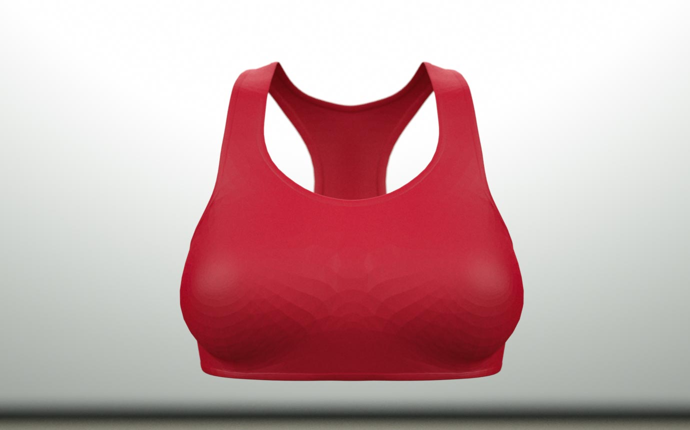

I just updated to 1.29 and for some reason a lot of my meshes appear like they need to be subdivided in Octane. This hadn't been the case before when I was on the Stable version. Is there a render option I need to fix?

Under setup in plugin window, make sure smooth by default is checked.

Cool. I'll do that. I didn't figure it was a bug, but couldn't find the thing to click. Subdividing everything was getting old! :lol:
