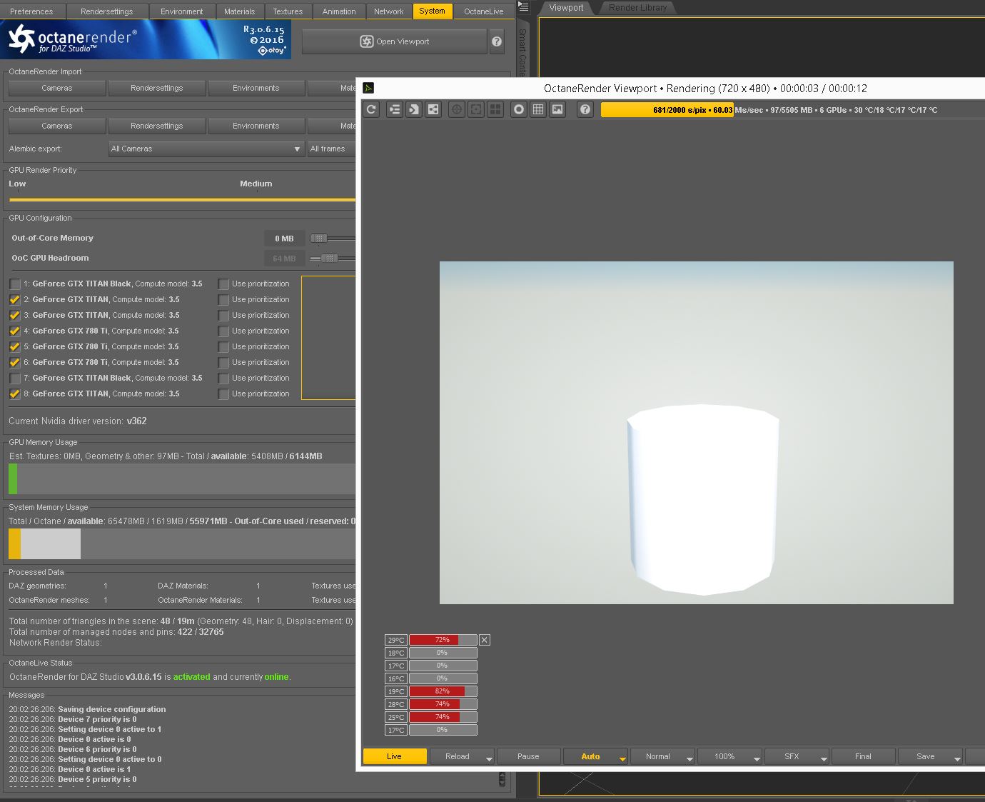

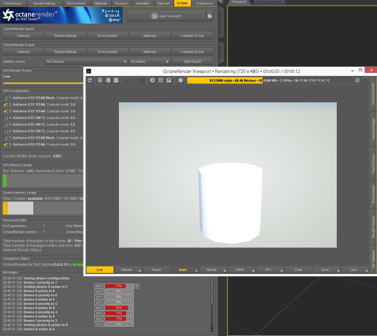

And something strange after I apply Configuration :
Note that 3 GPU selected, note that "2" GPU indicated at the viewport but 4 temperatures.
And note that 4 GPU are working on the monitor.
I7-3930K 64Go RAM Win8.1pro , main 3 titans + 780Ti

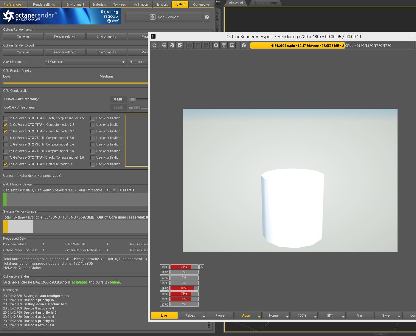

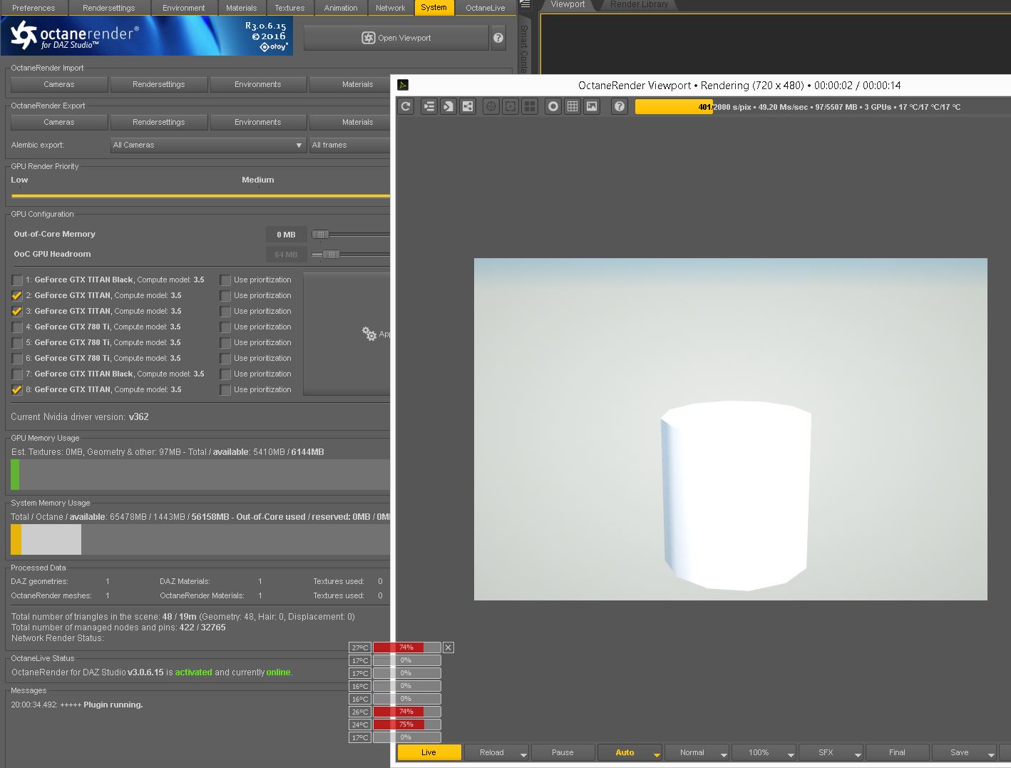

Here's my tests :
- Setup 3 GPU with V2
- Start DAZ with V3 and render
- Hit "Apply Configuration" (without selecting any GPU)
- Select all 780ti (6 GPU selected) and apply Configuration
And here is the debug.log
Xeon 2696V3 64Go RAM Win8.1/win10/win7, 2x 1080Ti + 3x 980Ti + 2x Titan Black

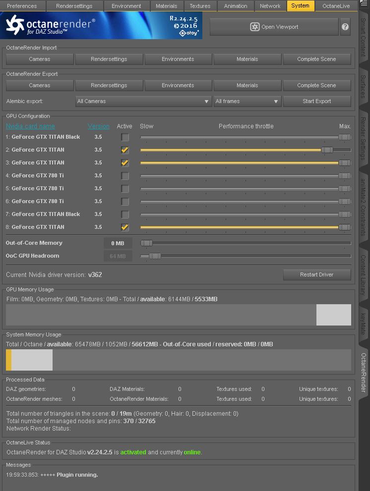

Thanks. You can see in the log that the plugin version is 2.24.2.5 - so something is amiss. I will investigate.... Sorry for the hassle on this issue.
