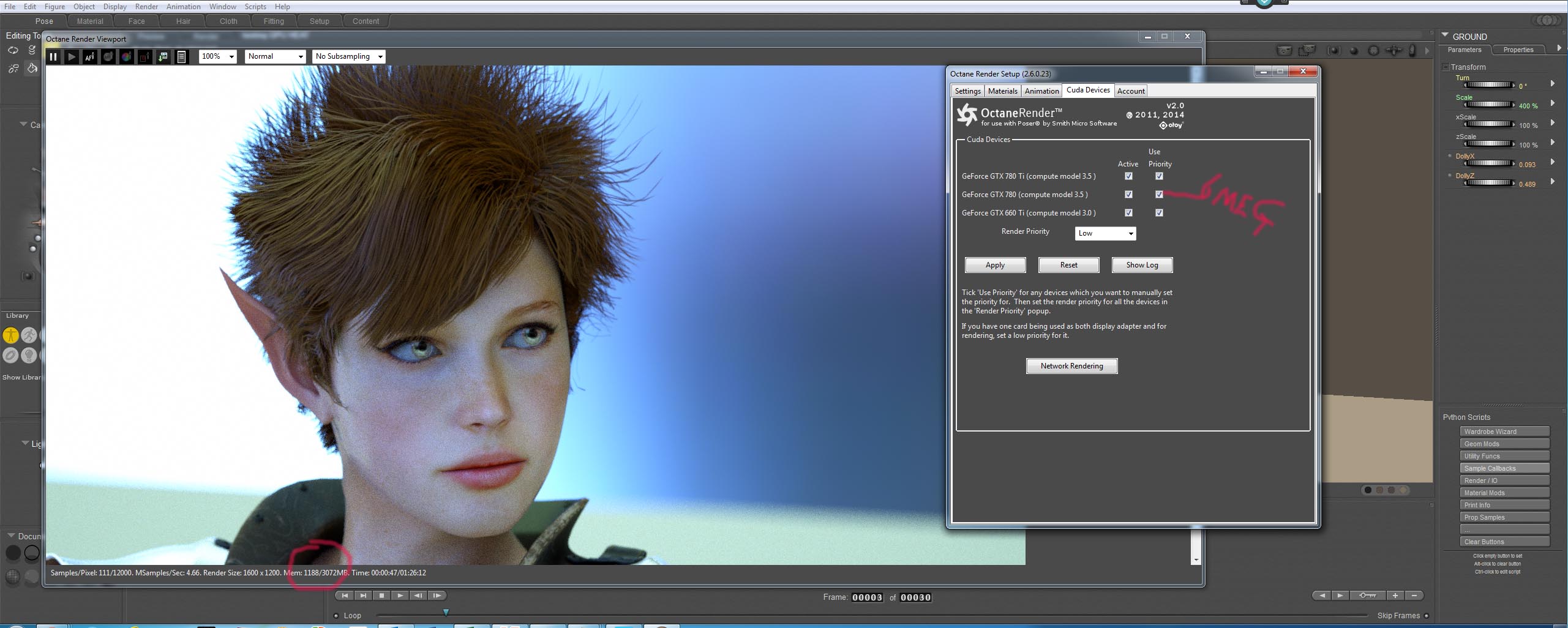

Hi Paul, I wonder if I could have an enhancement request, if possible.
I currently have three graphics cards on my motherboard . One is a NVIDIA GTX 780 TI 3meg
the other is a GTX 780 six meg and the third is a GTX 660 ti also three meg.
the problem currently lies . It always seems to load the three meg version never the six meg.
Fortune I can just remove the card. Where is a move it up a slot because of the motherboard configuration.
I'm sure that other people will have this issue. At some point. It is a rare issue. I admit
But I can simply go buy another 6 meg cards. Because I'm simply not made of money
Wonder if you could put in some kind of checking routine that would take the highest memory
first so would ignore the three meg cards can go with the master 6meg card , if that makes sense?

Chopper - turn off the 2 3GB cards in the plugin Devices tab, then click the Apply button. Then you can load a 6GB scene into you 6GB card.

Unfortunately not.
Always seems to default to 3 meg.
This is the process I use as I want to use all three cards.
First, only select the GTX 780 6 meg card
press apply open viewport (great works with six meg running with six meg)
Tick boxes on the other two graphics cards.
Press apply and as soon as you apply it, it defaults to the three meg graphics card
You're fine if you only apply the GTX 780 by itself.
If if you add the other two graphics cards afterwards. It automatically defaults to the three meg graphics card.
It's almost if it takes the top graphics card first e.g. the GTX 780 TI, which is a three meg graphics card.

Chopper - that's the way Octane works - it will drop down to use the VRAM amount of the smallest card that is selected for rendering. So to use 6GB, just render on your 6GB card.
