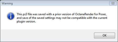

How do I get rid of this really annoying message when opening a file that was saved with the latest plugin loaded.
- Attachments
- message.jpg (9.71 KiB) Viewed 3988 times

Maybe a setting somewhere to toggle error messages on or off?RGUS wrote:How do I get rid of this really annoying message when opening a file that was saved with the latest plugin loaded.

That message should only popup when you load a pz3 file last saved with version 1.20 of the plugin. If you save the file that is popping that message, then reload that file, do you still get the message?How do I get rid of this really annoying message when opening a file that was saved with the latest plugin loaded.

Yes

That shouldn't be happening - I will check it out.Yes

Deane - can you pls start Poser, load the scene giving you the error, open the plugin (don't open the Viewport), then send me the octaneplugin.log file pls.That shouldn't be happening - I will check it out.

I had the same popup.face_off wrote:That message should only popup when you load a pz3 file last saved with version 1.20 of the plugin. If you save the file that is popping that message, then reload that file, do you still get the message?How do I get rid of this really annoying message when opening a file that was saved with the latest plugin loaded.
Paul
I was using PP2012 and the plugin vers. 1.25.xx while I was creating the scene.
When I was now loading this scene with the updated plugin vers. 1.29.xx, I always had this popup, too.
As suggested, I re-saved the same scene with 1.29.xx. The popup does not appear any more.
The log ( plug-in setup window -> Cuda Device -> Show Log *when the error was still appearing*) said the following:
Started logging on 01.02.14 23:53:03
OctaneRender version 1.29 (1290000)
Failed to load preferences from "C:\Users\Name\AppData\Roaming\OctaneRender\preferences_v2"
Setting "parameters" not found
Setting "defaultResolutionPreset" not found
Setting "defaultResolutionX" not found
Setting "defaultResolutionY" not found
Setting "default_node_graph_toolbar" not found
Setting "default_node_stack_toolbar" not found
Setting "default_render_toolbar" not found
Setting "default_outliner_toolbar" not found
Setting "system" not found
Setting "gpu_name_0" not found
Setting "importSmooth" not found
Setting "roughness" not found
Setting "index" not found
Setting "last_used_0" not found
Setting "last_used_1" not found
Setting "last_used_2" not found
Setting "last_used_3" not found
Setting "last_used_4" not found
Setting "last_used_5" not found
Setting "last_used_6" not found
Setting "last_used_7" not found
Setting "last_used_8" not found
Setting "last_used_9" not found
Setting "last_used_10" not found
Setting "last_used_11" not found
Edit:
I noticed now, that there's no "preferences_v2" file in the above (by the log) mentioned folder. Perhaps that's why there're so many "not found" lines, hehe.
