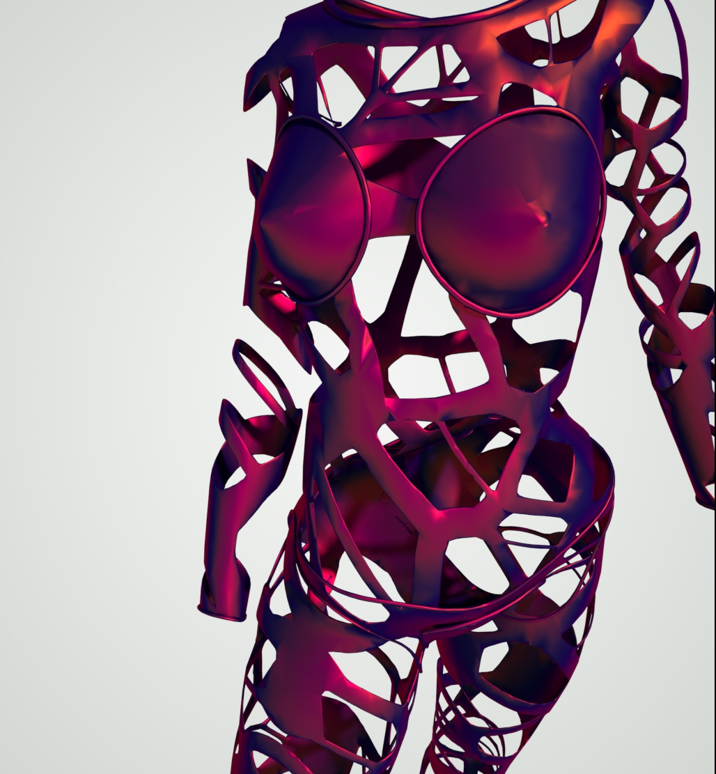

Trying to create my own cloths using a voronoi algorithm inside grasshopper and rhino. I noticed there are a lot of mesh texture showing through, I've tried a lot of different things to smooth out the polys. Does anyone have any suggestion on how to get Daz to work with low poly count?

I presume you already tried using Daz Studio's built in subdivision, and can't think of anything else off the top of my head.

I work with low poly meshes in hexagon and just sub-d them in daz studio. Depending on if you have enough geometry in the right places it tends to work fine. Also there are 3 or 4 different smoothing options for sub-d and switching between them can help keep the shape the way you want.

I wasn't getting anywhere with the Daz built-in utility, but the Hexagon "Smooth" and "Decimate" utilities got down to business.
The only problem with Hexagon is the "Send to Daz" button causes a crash and exporting as .obj shrinks it down to 3 cm tall (even after setting the scaling options).
Nonetheless, I'm making headway and will play around with the setting until I get a better grasp on it. Thanks for the suggestions. Saved me a couple of days of aggravation.

hmm not sure why Sub-d didn't work, did you try the different smoothing modes? Also how many polys is the mesh? Relooking at the mesh, it seems like it may actually have suitable geometry density, but the smoothing settings in the base program could play a role.kraken wrote:I wasn't getting anywhere with the Daz built-in utility, but the Hexagon "Smooth" and "Decimate" utilities got down to business.
I never had a problem with sending items back to daz studio either...I'm guessing there is something with your mesh that is causing issues. I use the daz/hexagon pairing daily and never have issues sending between the two programs.
I certainly see improvement with your recent output but I still see the hard edges, so I think how the model is crafted is what is causing the results. Often enough turning an edge here and there improves how smooth the model looks.

Maybe its a system issue. Its crashes, all versions, within 10 minutes of launching Hexagon. Granted, I don't have a clue how it works, mostly because it crashes before learning anything. I've avoided it like the black plague ever since installing it.I use the daz/hexagon pairing daily and never have issues sending between the two programs.
WHat I noticed is that exporting the genesis model has "x" amount of polys in the .obj file. Re opening it in Daz and its clearly not smooth. Definitely a problem with the way I'm handling these geometries. I hate sounding like whiney school girl, but the manuals for Daz really suck.
I appreciate any help you can offer as it was probably learned through trial by fire.

Yes the daz manuals or lack thereof are a common complaint in the community so I don't think you are unjustified in saying that.kraken wrote:the manuals for Daz really suck.
I forgot for a minute that Hexagon used to crash on me within a few clicks of opening it up as well. So I hated it. But some ppl including vendors in the Daz community swear by it and claimed to be able to use it for hours straight. So on the daz hexagon subforum I picked up a few tips for settings to change for hexagon that make it more stable. I would suggest heading over there if you are interesting in seeing if you can getting operational.
But for the smoothing issue, maybe you can make sure the smoothing groups in the host 3d application are set up correctly? It could just be surface smoothing setting that is part of the issue. It's really hard to tell with so many variables at play.

I'm not sure decimating is a good idea. Decimation reduces the polycount by optimizing the polygon layout to your specifik geometry. This means that it's not going to be optimal for conforming to other poses. Decimation also converts the mesh to triangles, which are not optimal for subdivision operations. For subdivision you want quads, as in the original DAZ model).
I don't think smoothing groups are carryed over to DAZ as something to do with smoothing, maybe as materials groups.
You need to be aware of your subdivision level when you export. A DAZ character at base resoultion should give you a model with around 20.000 faces. It's only because DAZ subdivides this model that it actually looks smooth in the viewport and renderer, so if you reimport that model, it won't look smooth. You need to apply the smooth modifier in DAZ and go to subdivision level 1.
And yeah hexagon also drives me crazy. If you stay away from the sculpting tools it seems semi-stable though. I use Blender instead.
Edit: Also the "smooth" property of the Octane shaders isn't always on by default in 2.1! Maybe that's all that's wrong in your original post.

One of the most common fixes (on 64 bit OSes, anyway), is to use the utility I cannot recall the name of, that modifies the 3 GB Ram limit of 32 bit programs. For many programs, it can be unstable, for Hexagon, it makes it function for me (on Windows 7 64 bit). I know the info is in the Daz forums somewhere for it, likely near the top of the list in most lists of fixes. If it's crashing shortly after opening, that may be part of your issue. I've noticed that it has a tendency to try to eat RAM for a while, then eventually settles down. Its myriad issues are likely why zBrush was embraced by many users and vendors, though a lot of them do still swear by Hexagon. Personal preference, I suppose.
