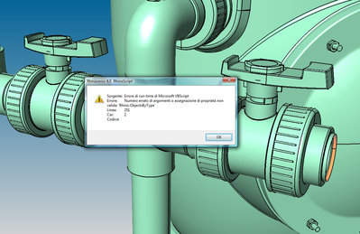

Hi Sam,
a great thanks for all the work you do.
Using Rhino v4 SR9 and when I try to send a rendering, displays the following error message.
Thanks in advance for any suggestions.

Very sorry for the delay in getting to this, it somehow slipped through the cracks. This looks like a V4 error only. Which version of the exporter are you using? My *.rhp complied one, the individual *.rvb files, or gmillas *.rhp? If you are using the individual *.rvb files, then replace functions.rvb with the one attached. I will attempt to recompile this into a *.rhp as well.depursystems wrote:Hi Sam,

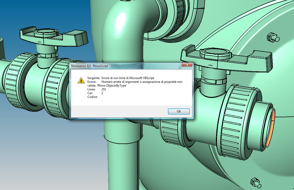

Good work!
Francesco
Side note to gmillas, if you want to update your code, these are the changes I made (in around line 244 of functions.rvb, there was also a redundant Rhino.UnselectAllObjects in there as well that I took out, so yours might be a couple of lines off):
Code: Select all
'Select surfaces, Polysurfaces, Blocks, meshes
'If it is Rhino5, we also want to select extrusions
If Rhino.Version > 20110309 Then
'Rhino 5 w/ Extrusions
arrObjects = Rhino.ObjectsByType(1073745976, False, 3)
Else
'Pre extrusions, probably V4
' V4 didn't have the third argument, object state (normal, locked, and hidden).
' In the V5 case above set to take normal and locked objects,
' don't take hidden.
' As this doesn't exist in V4, we have to take a slightly more
' manual approach to leave the hidden objects behind
' locked objects have already been unlocked above
Rhino.Command "_SelAll"
arrObjects = Rhino.GetObjects( , 4152, True, True, False)
End If
