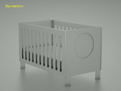

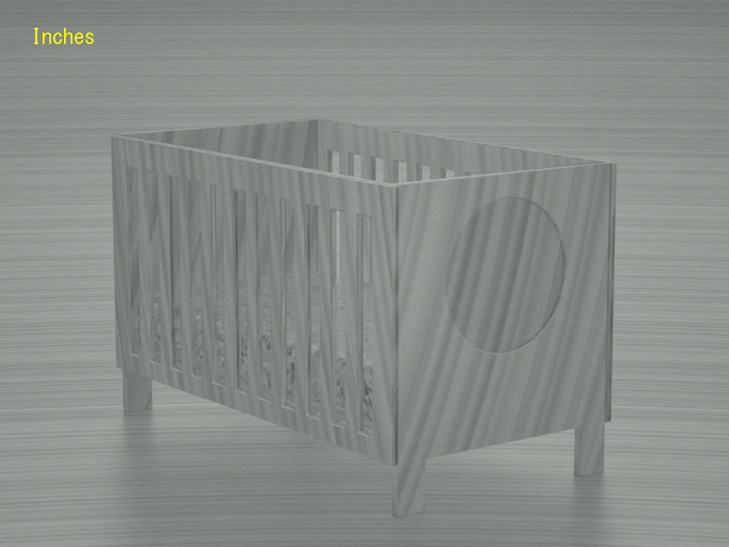

My newest client makes his blueprint in "inches", so I've been modeling using 1 XSI grid = 1 inch.
When I tried to render them, I'm getting strange rayepsilon marks.
Am I doing something wrong?

The problem with the scaling is, you can model in which unit you need. The important thing is the overall size of the scene.monkeyjet wrote:Hi face,
First, thank you for making this plugin. I've been enjoying using it.
I have one problem.
Please check my settings.
Thank you
Means, you can have a scene which has a size of 100.000.000mm, then you should export it in km.

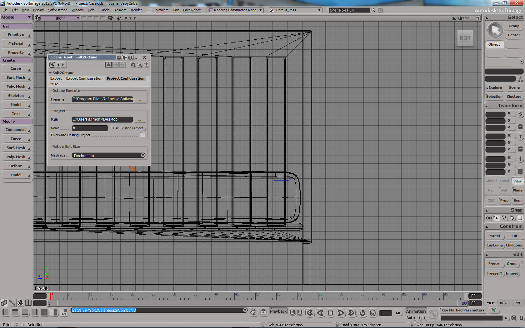

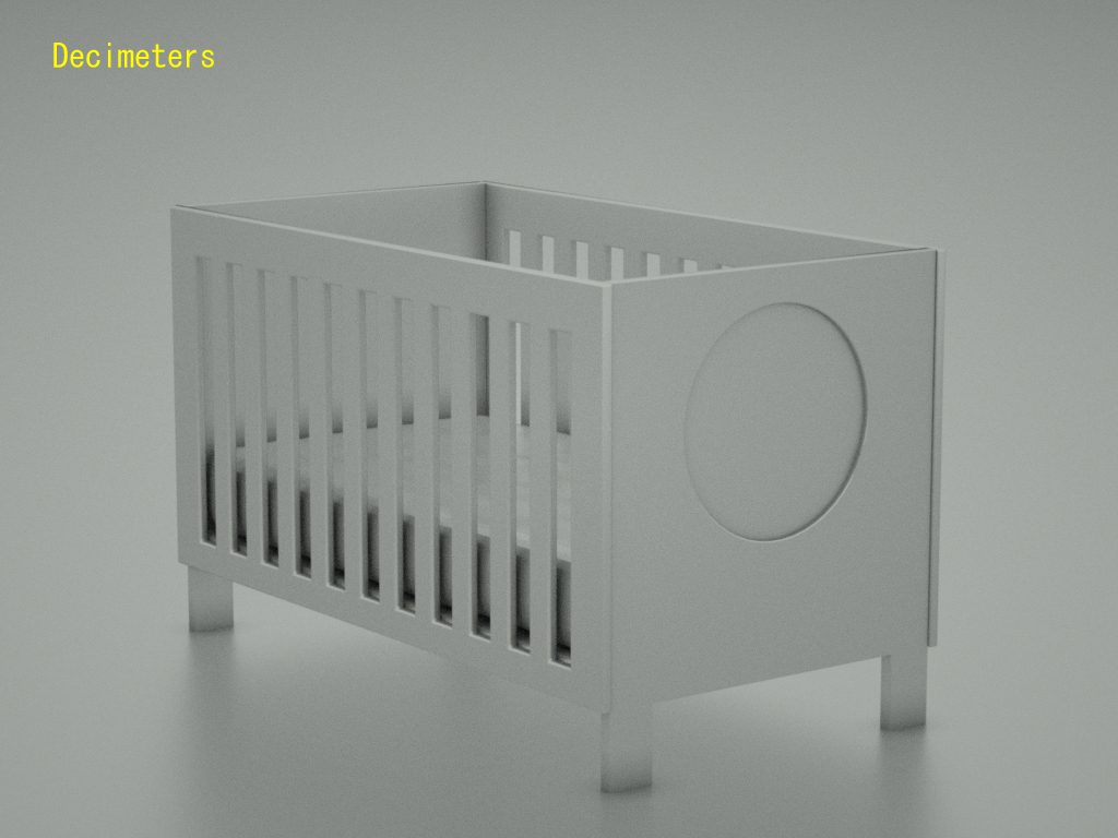

When you work in dimensions like 100m, switch from decimeter to meter in the "Project Configuration" tab.
This will change the aperture range from m to dam (10m).
