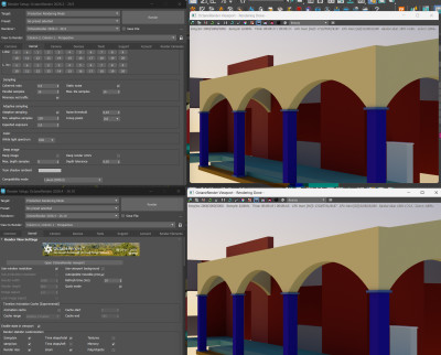

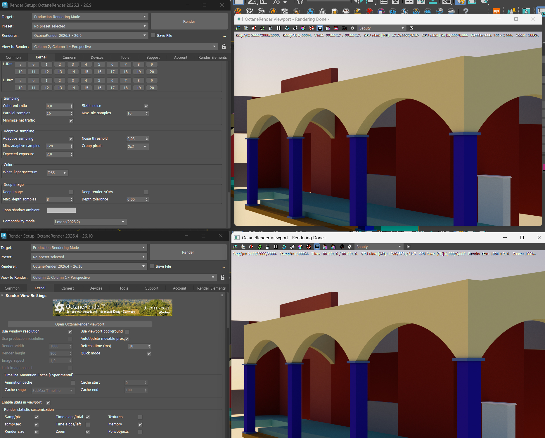

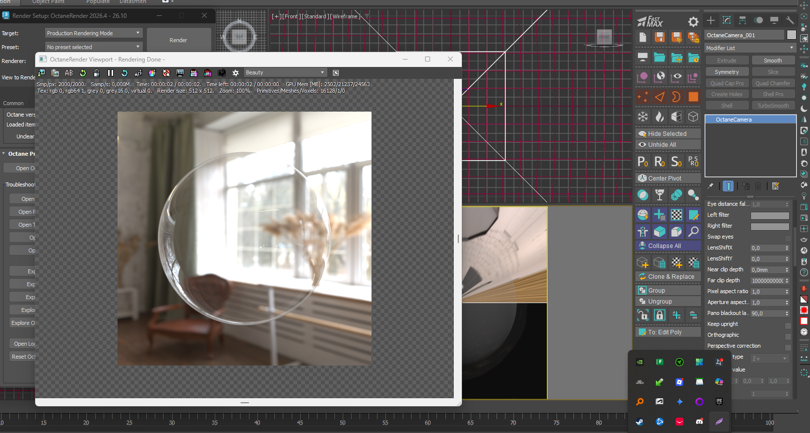

This is the OctaneRender_Studio+_2026_3_for_3dsmax_v26.9 version, without rendering details, polygons, or algorithm processing in the viewport.
Thanks OR team.
OctaneRender® 2026.4 for 3ds max® v26.10

Hi Pelana001_1,
I think it's just a matter of perspective and lighting.
Regards
Paride
Regards
Paride

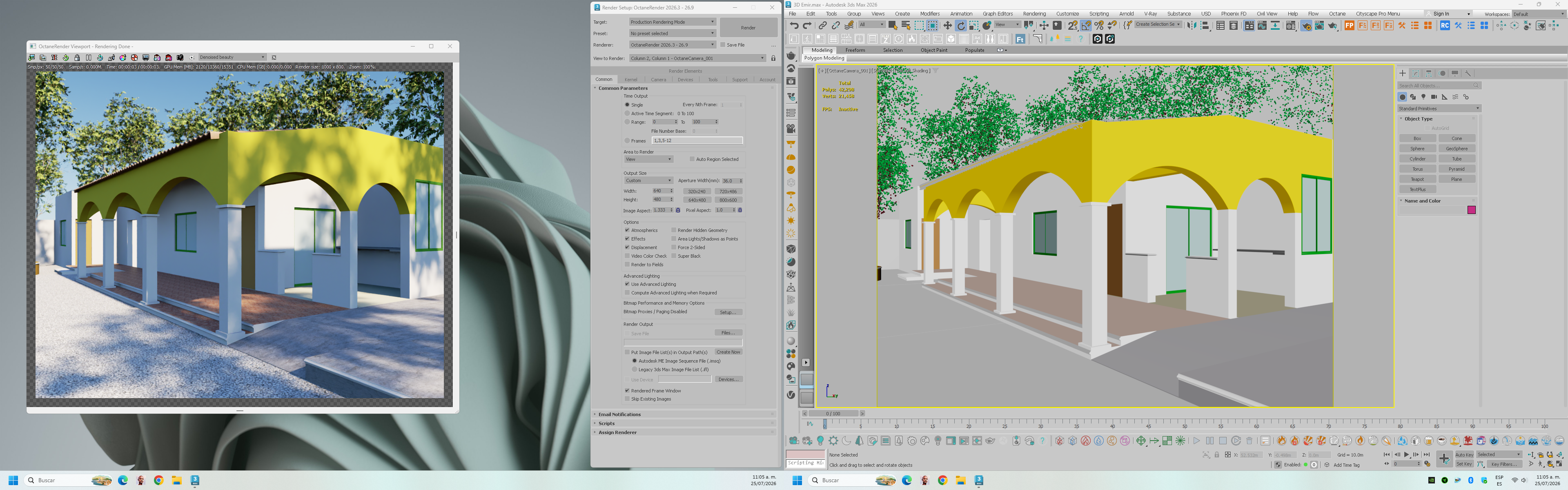

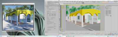

- Pelana001_1
- Posts: 45
- Joined: Wed Sep 18, 2024 10:46 pm
- Location: Mérida, Yucatán
- Contact:
HI paride4331, thanks for answer, very kind, I'll using the version OctaneRender® 2026.3 for 3ds max® v26.9 and I don't have issues.

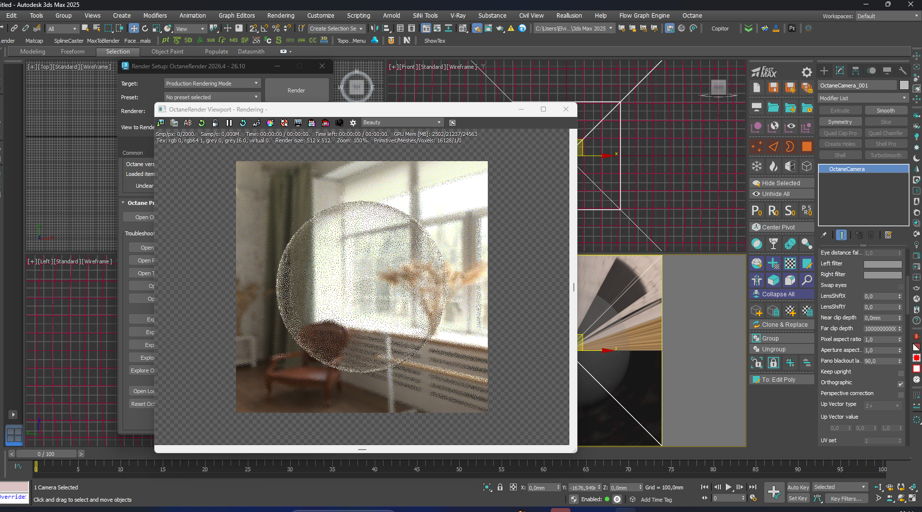

The orthographic camera is broken.
- Attachments
- Bug The orthographic camera.rar
- (19.08 MiB) Downloaded 68 times
- Elvissuperstar007
- Posts: 2619
- Location: Ukraine
- Contact:
The bug does exist after all; it doesn't happen every time, but it shows up in 70% of cases.
- paride4331
- Posts: 4002
Hi Elvissuperstar007,
Thanks. I've submitted my report to the developers. As a temporary workaround, switch to a different 3ds Max viewport and then switch back to the Octane Camera viewport. This causes the render to resume progressing. However, if the Ortho option is turned off and then back on, the issue reappears, and you'll need to repeat the same workaround.
Regards
Paride
